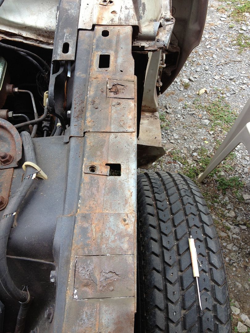

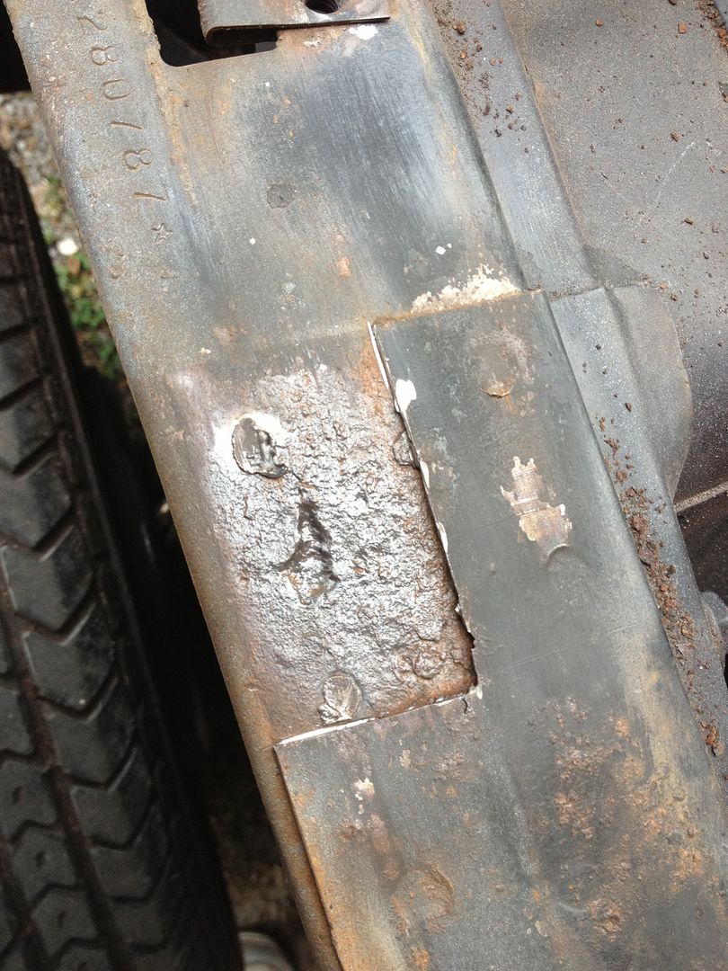

    I started cutting the rust out of the aprons.

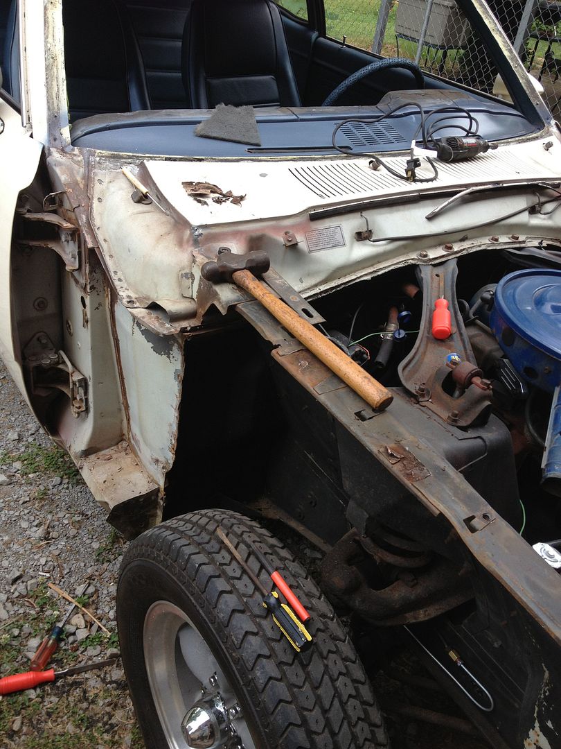

    Cowl appears to be in great shape. Going to treat the inside for protection before the fenders go back on.
    Cleaning up the outer cowl seams

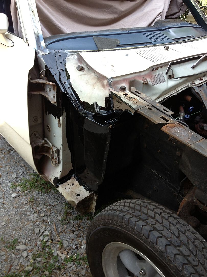

    Applying some POR 15
  10. blugene
    10,776
    This is the kind of work I don't like.. There is so much of it.. Makes me wish I could just sand blast the whole car at once inside and out.

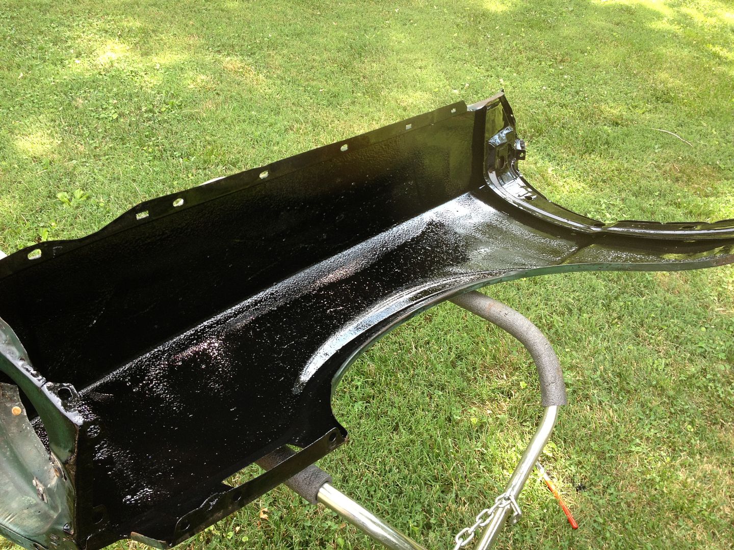

    The rt fender I got out of Georgia getting the POR 15 treatment.

  13. predfan2001
    I think the problem with the rust on these cars were that they were built so cheap. After fixing up a few 60s Mustangs and Fairlanes it seems to me that Mavericks had really poor fitting seams and overlaping bare metal. All of the cowl seam sealer had let go years ago and the seams had a good bit of surface rust.
    I'm really wanting to get these areas taken care of this week so I can get fenders and hood back on it. I'm debating wheather or not to use POR15 on the bottom of the hood. If nothing else I'm going to pour some in the back of the hood lip. This is the first time I've used POR15 and I like it pretty good. I'm probably going to get some grey for inside the trunk after I gt the quarters patched up.

  15. predfan2001
    I got all the cowl seams sealed up with black Eastwood body seam sealer tonight. That didn't take long after work, so I got my Hobart Handler 140 out and finally switched it from flux to MIG and gave it a try. I got this for thin sheet metal....and it is sweeeeeeettttt!
