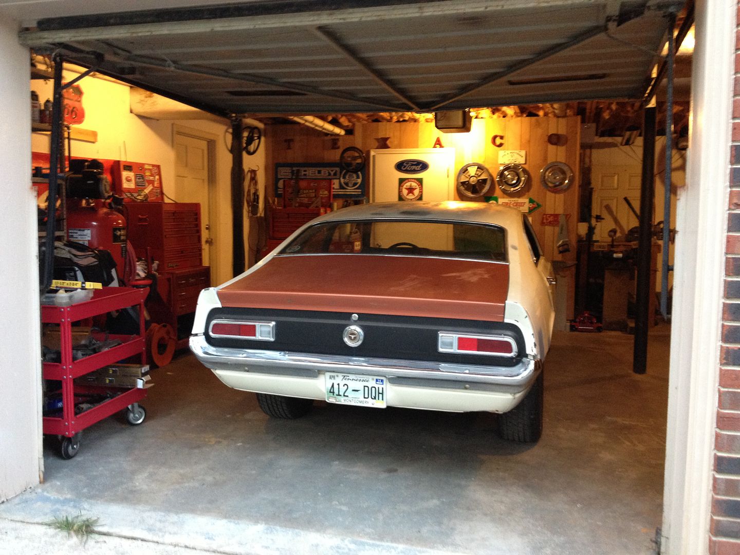

  1. predfan2001

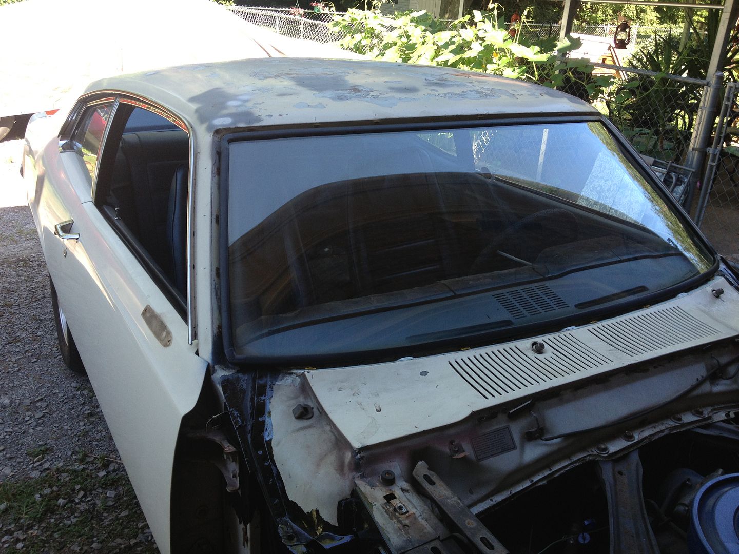

    Yep it's attached. First thing I wanted to get done was to get the windshield set back in. I cracked the Comet windshield. Still not sure how that happened. It was in and the last pull of the rope it cracked. Good thing I had a back up. On the brighter side...it still has the original windshield. :16suspect

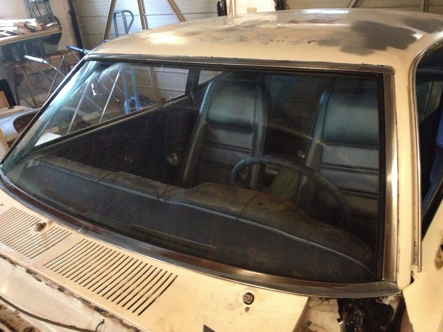

    Sealed up and moldings on.

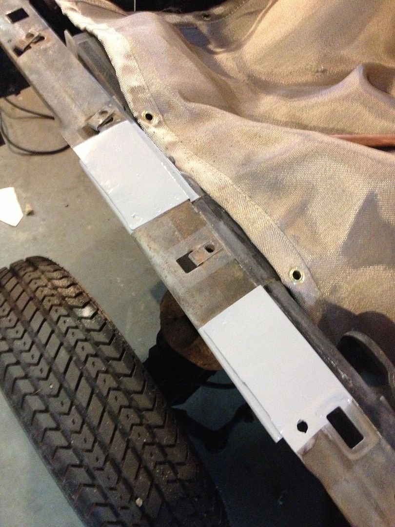

    Put off welding till tomorrow because the 5 patches I need to weld in needed to be sprayed with weld thru primer and I needed to prep the areas a little.

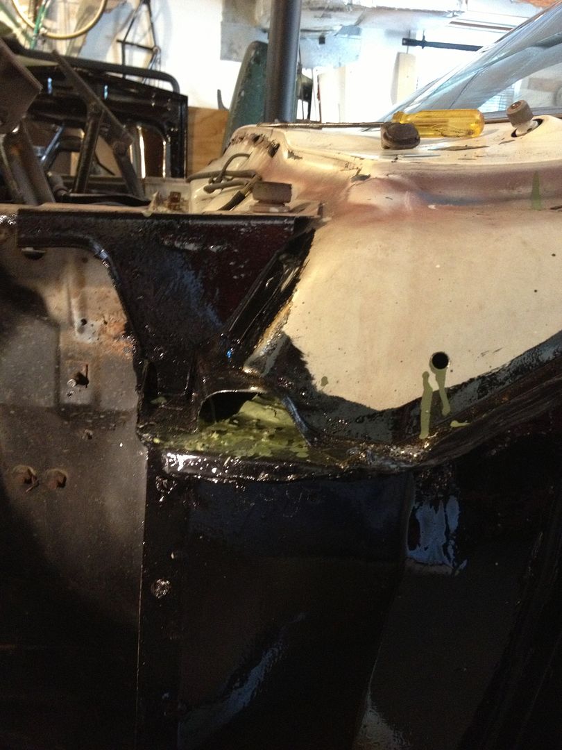

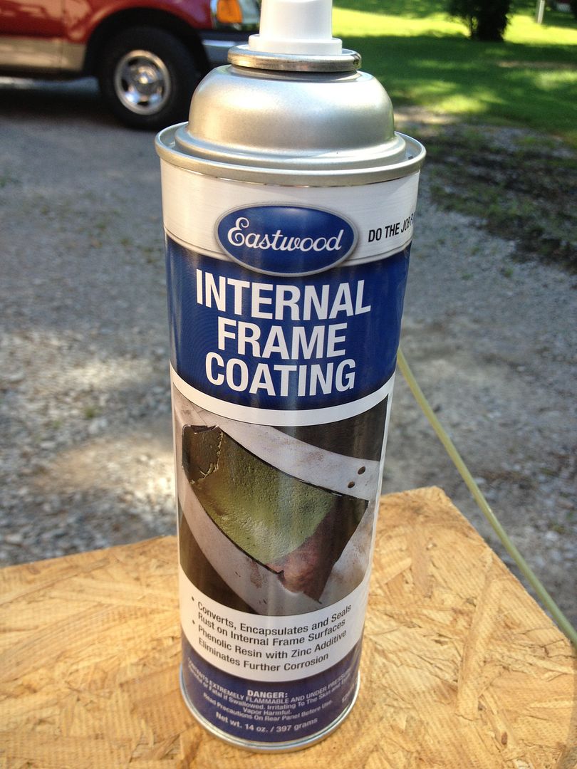

    The time had come to try out my idea for protecting my cowls from rust (or rusting anyone worse). This is the product I used:
    The can has a long hose with a small brass spray nozzle on the end. I removed the plugs in the top of the cowl (look like a rubber wedge) and drilled 2 other access holes. I dropped the hose down in the cowl vents and maneuvered it over pointing at the cowl top hat and sprayed the base. Then thru the top hole where the rubber wedge was. Then the 2 other holes I drill and last up thru the drain.
    It might not do a thing but I figured it's worth a shot since the fenders were off.

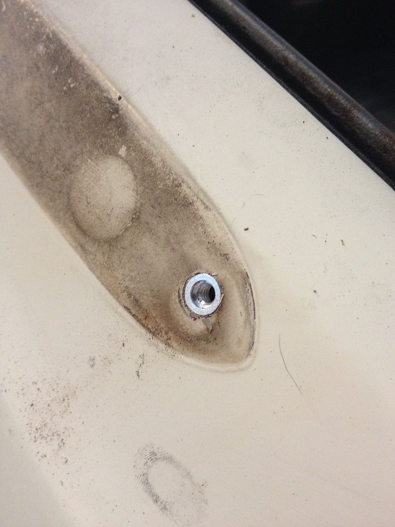

    Also tried out my Rivnut gun.

    Its like zinc dichromate...Workes for aircraft...Should work for cars...I coated everything that hose would fit in on my mav project. Coverage is actually better than you think with that spray nozzle.

    Nice progress.. I like the rivnut.

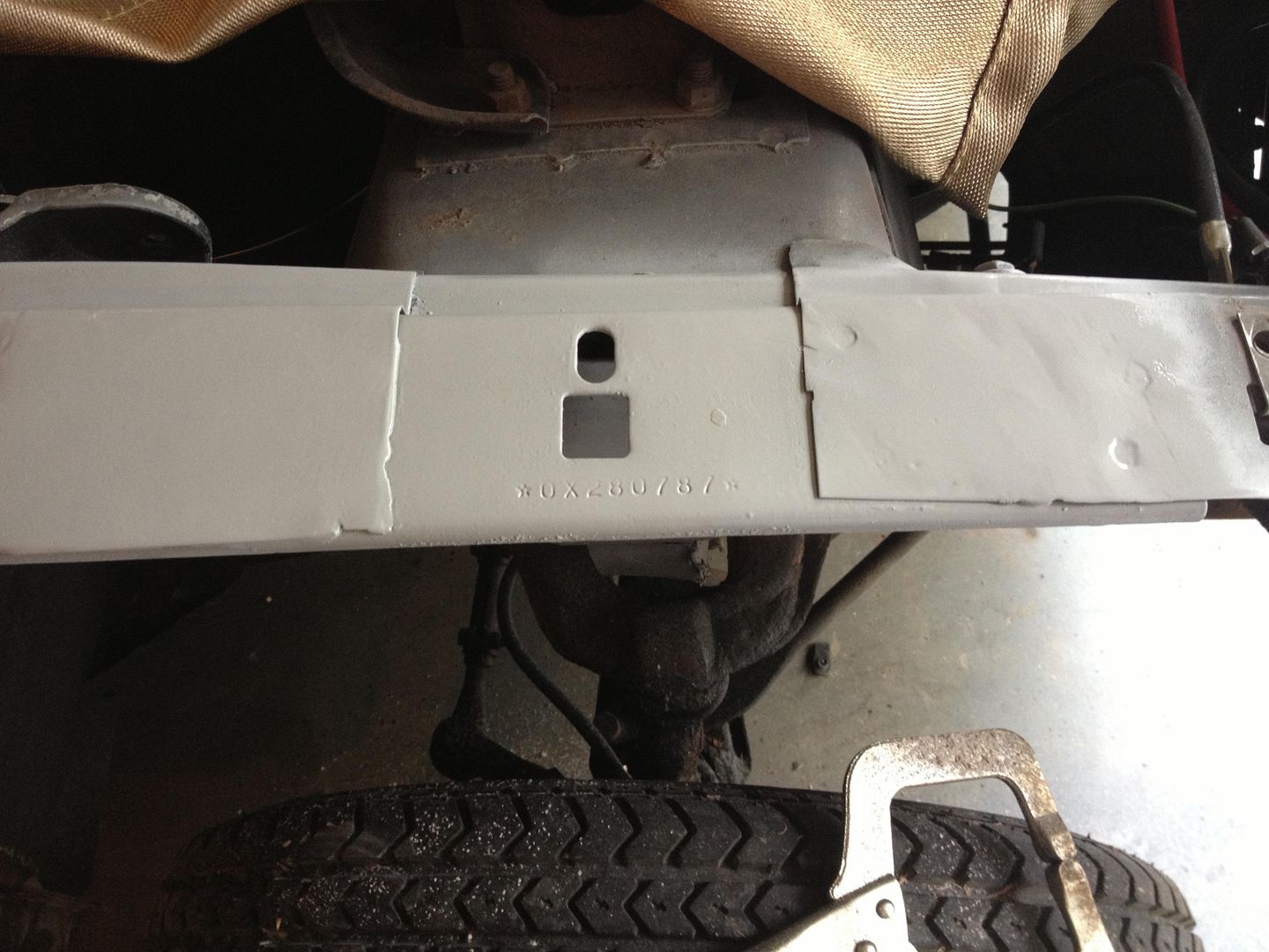

    Left apron welded up.

    Looks good. Are you doing a complete paint job now or later? And where did you get your rivnut tool? I got one from harbor freight many years ago and it didn't work very well. I'm not sure if it was the quality of the tool or the quality of the rivnuts that came with the tool(they were pretty cheap looking).

    I found the rivnut tool at a local wholesale outlet. Seems to work good.

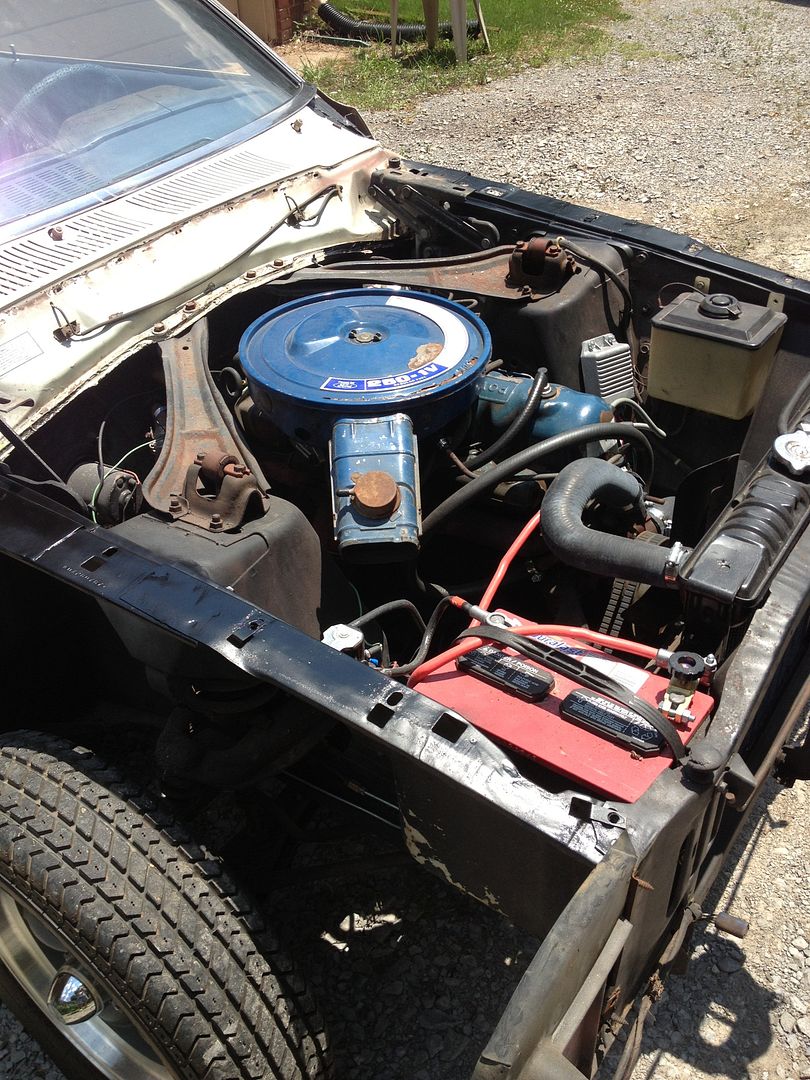

    The right apron turned into a headache. The metal was still thin in the areas I was going to weld up so I had to cut out much bigger areas than planned and make new patches to weld in. Thankfully most all of this is under the fender so it can't be seen.
    I gave the areas under the fenders a coat of satin black.

    Got the hood and rt fender on. Left fender can't go on till I weld up the LDO trim holes.

    It is interesting where the VIN number is stambed on the shock tower. I have never seen one stamped that far back on the front of the car. I have usually found it on the front aprons.
  12. predfan2001
    It's there on both sides. I'm guessing by the VIN thread here my car is fairly early for a 70 (not 69.5). My door panels are coded Dec 68.

    Todays project has been the windshield. Dumb me didn't watertest it before I put the moldings on and it had a leak. I'm pretty sure the sealer was old. It was very hard to get to come out of the tube. I dug out everything I could and re-sealed it again with fresh 3m sealer. I hope it holds...if not I'll order a new tinted glass and let a pro do it. This is the first one I've had problems with.
