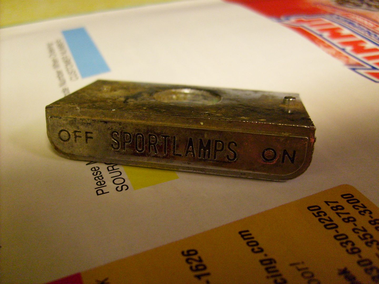

  11. predfan2001
    Thanks Craig....$$$ on the way. Thought I'd pull the gas tank out tonight and slosh it out...no such luck. I poured about 1 gallon of the smellyist fuel ever out and it sounded like gravel was in the tank. It looks like Corn Flakes and rust. I did alot more reading here today and since mine is a 70, my options are few. I'm gonna see if I can have a shop check the tank to see if it is salvagable....if not looks my truck floor is gonna get cut out for a Mustang tank. Personally I'd sort of rather get it over with and know I'm starting off with a new tank. We'll see.
