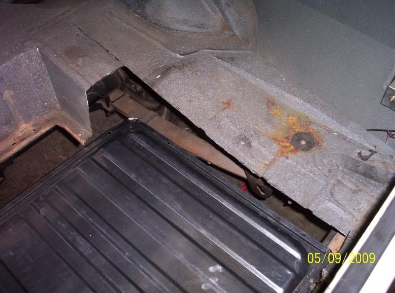

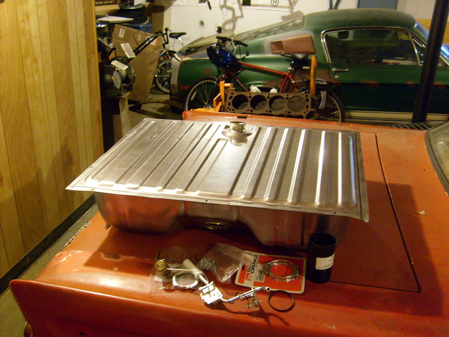

    I got the Mustang tank in today for my Maverick. It came with everything to install it....even a new inlet hose and mounting bolts. It had a small bend on one edge but no big deal to straighten.
    Next step is to cut my floor out and extend the rt side over to fit the Mustang tank. Here's a pic from another member who did this. I plan on cutting mine different...completely moving the rt side over and lapping it so I can spot weld it all back in place.

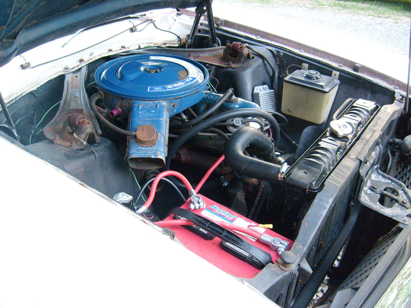

    So here was the nightmare under the hood 2 months ago:
    Here it is today. A $200 Craigslist engine and tranny plus many other new parts to get them installed. The wiring to the DS module is temporary and I bypassed the heater core suspecting issues. Pretty good progress so far...I hope it continues!
