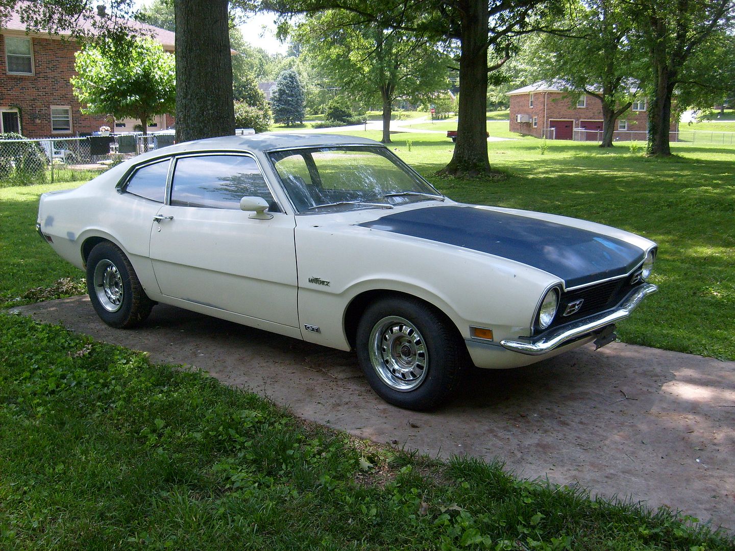

  15. predfan2001
    I drove the car (if you can call it that since it has no brakes) for the last time for awhile. I pulled back out to the concrete pad so I can start teardown. Starting next week I'll start removing stuff to make way for the correct width rear end, correct leaf springs, new shocks, 70 Mustang frt backing plates, and all new brakes (everything new but the hard lines).
    While it's down I am going to rebuild the carburetor and remove some of the 77 emissions stuff from the motor. Hopefully I'll have brakes soon and it will be somewhat driveable. :drive:
