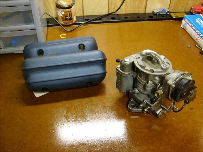

    I had posted somewhere here before about my air cleaner shaking really bad at an idle, then I removed it and found the carb was actually shaking. Well while trying to rebuild the carb I found out why...the screws in the carb that hold it to the base are stripped. Someone had even tried to put a different screw in on of the holes. Now I gotta find a carb.

  8. predfan2001
    I don't have any tiny fine thread taps or screws (if they even make them??)....so I said screw it and just ordered a reman. carb. I could have tried to find a buildable core, but my luck is it would be bad too. I got a new Holley reman for $105.00 so I guess but the time you factor in the cost of a kit, a core and a new choke...that ain't so bad. I'm also removing all of this 77 model emissions junk while I'm at it. I ordered an EGR block off plate and I'm removing and plugging several things. Wanna keep it simple like in 1970!

    Yep that's what I'm thinking....but have a lot of wheels in reserve, just none I thought would look good on a driver Maverick. So far I guess it will be my nos 14" Cragars (yuck), 15" steel wheels off of a Boss, or skinny and wide Torq Thrusts. Looks like it might be the Torq Thrusts.
    Got the carb in yesterday and it looks great. I gotta get my %#$ in gear this weekend if it's not raining.
    Here's the carb and armrests I got from Craig
    I needed turn signals since my were long gone. I got 2 sets...I hope to make 1 really nice set
    Finally here's my EGR block off. A shame it is so nice and can't be seen....but it was cheap

    Sounds like a good call on getting a new carb.
    Just wanted to add that if you had wanted to take a stab at fixing the threads on the old one, Loctite makes a thread repair kit that works pretty well. It is an epoxy and you thread the bolt into it while wet to restore the threads. You can then thread the bolt back out and the repair will be good for a few uses. It is good for fasteners up to 30 ft-lbs of torque. I would use it after cleaning the carb ... don't know it would hold up soaking in carb cleaner, etc.
