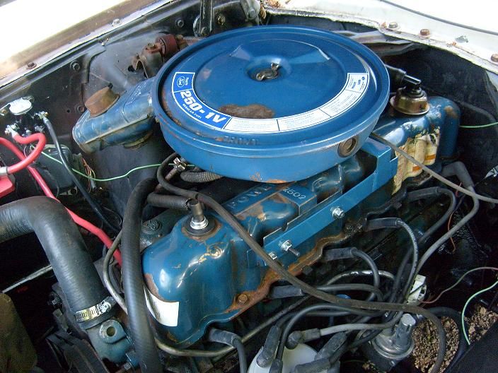

  1. predfan2001
    I got the new carb on and removed all of the EGR and emissions stuff. It purrs like a kitten and runs great right out of the box but I found out the carb. is California emissions. I heard it would run lean but it actually seems a little rich. I guess I'll try it out and see how it does....I haven't adjusted anything yet.
    Here's the EGR block off for a 5.0 that I used. It was only $14.00 inc. the gasket. I need 1 more plug for the air cleaner.
    The engine bay is a little less cluttered than when it had vacuum hoses running everywhere.
    The throttle cable bracket on this 77 model engine wouldn't work with my 70 model cable so I grabbed some metal and welded up a bracket. Filing out the square hole for the throttle cable end SUCKED but it works perfect.
    Soon I'll have everything wrapped up under the hood and I will degrease and paint the engine along with the rest of the engine compt.

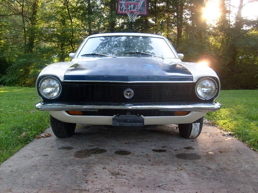

  2. predfan2001
    Not planning on doing alot to the car today, but I did throw the original grille back in and I'm getting ready to install the parking lights I just received. Not sure which style grille I'm gonna use yet....just wanted to see what it looked like. That grill hasn't been on the car since the 80s.

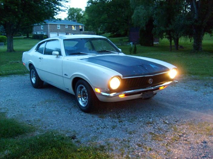

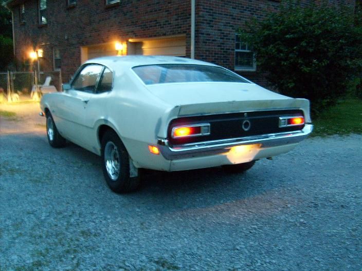

  3. predfan2001
    Ok this is killing me.......I wanna drive it so bad! Just gotta get the brakes finihed up first. This thing runs perfect...the new carb made all the difference. I got the parking lights on tonight and checked the lighting...all seems good.

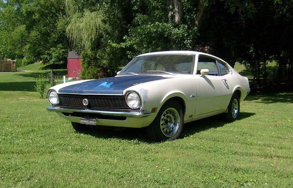

  8. predfan2001
    I ran across this pic today. It was when I first got my car when I was 15 and had just painted the grille black.....still had the hubcaps. And that's my old dog Tippy on the hood...and I think she's the one that chewed to corner of the picture.

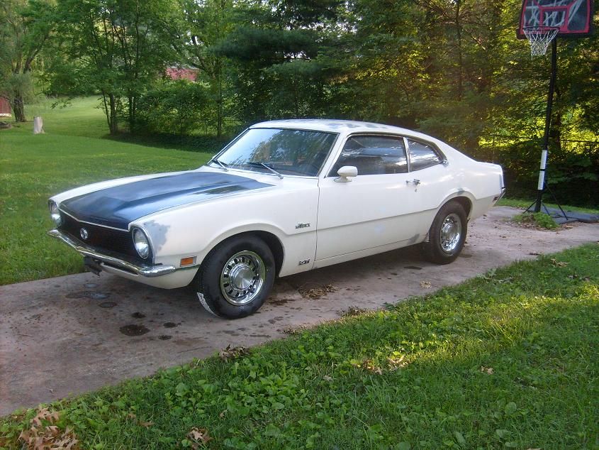

  10. predfan2001
    Still working at just getting it back in one piece and drivable (y)

  12. predfan2001
    It's actually a blue hood I bought from Raymond. :oops:
    It will all be Pastel blue soon....or Acacapulco blue??? :yup:

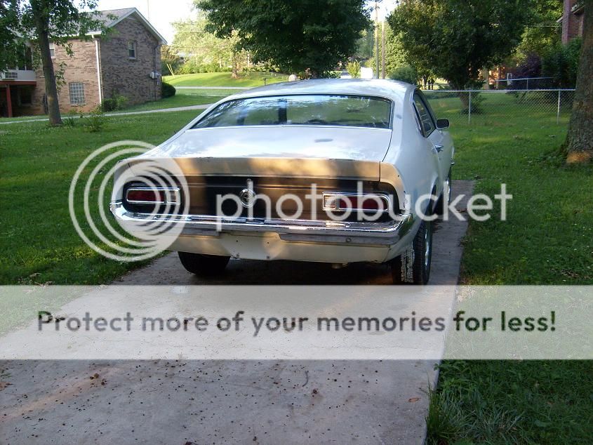

    This was a very busy weekend so I didn't get much done on the Mav. I put the radio & speakers in and wired it up. I pretty well got the temp gauge done. Reglued the rear view mirror vacuumed more dead ants out. When I pulled the carpet back to run the speakers, I found no signs of rust in the floorpans.
    I really need to make up my mind about the rear end soon so I can get the brakes done.

  15. predfan2001
    Ok....I'm putting a Maverick 8" under this weekend. If it does look too narrow with these wheels, I'll put some other wheels on it. I'm also getting rid of the Granada leaf springs and reinstalling Mav springs too so that will drop the a$$ end alot....I hope not too low. :dizzy:
