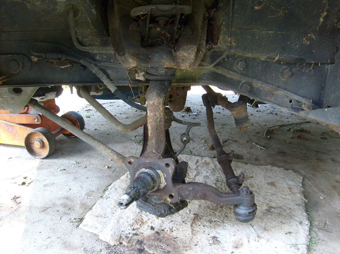

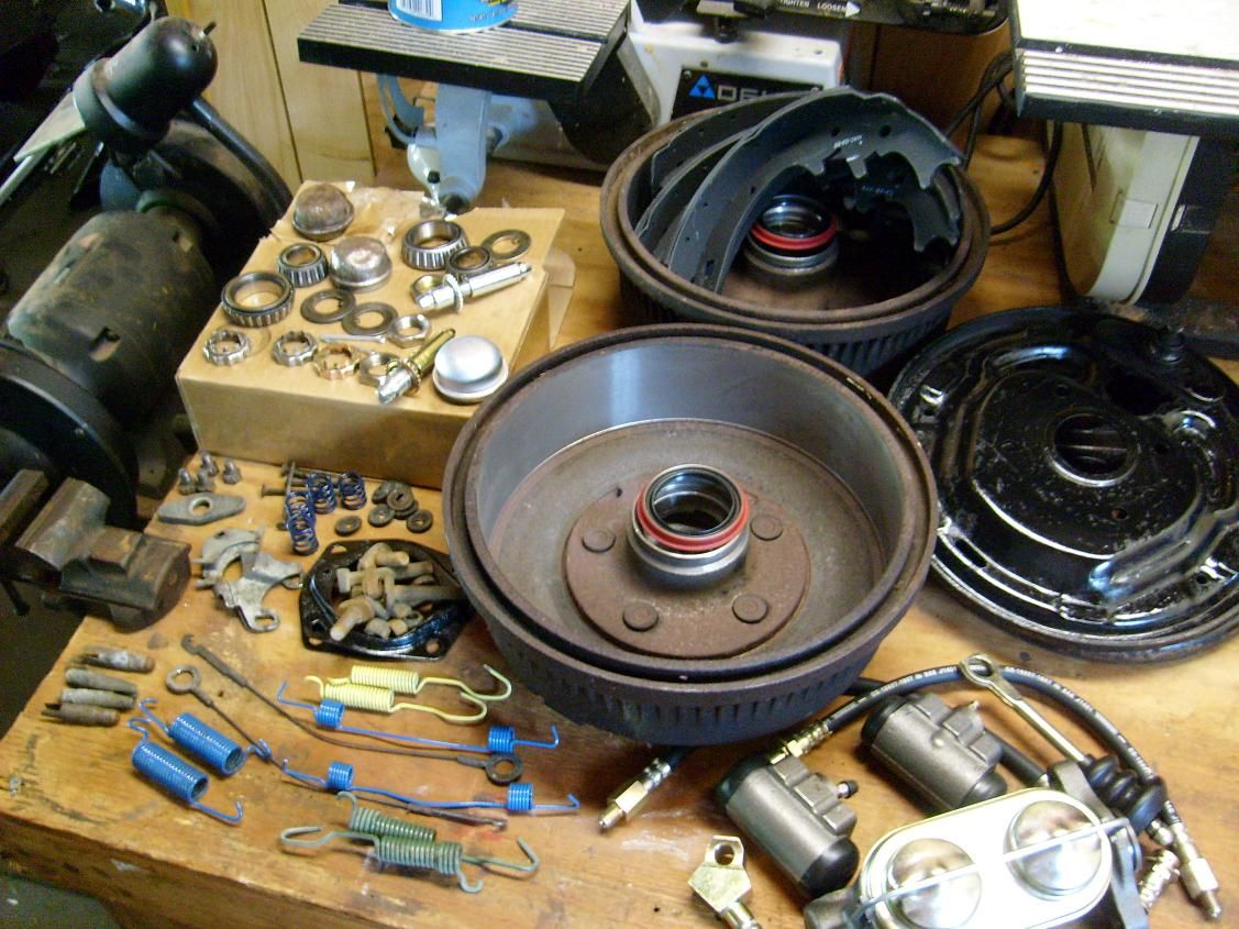

  4. predfan2001
    Today I have the frt brakes stripped down to the spindles. Expected to get more done, but I have spent most of the day cleaning parts. The Mustang backing plates that I am using have been undercoated on the back so I am going to have to let them soak in solvent awhile....but everything is looking good.
    I had some fairly new frt wheel brgs that I planned on using but I noticed 1 had a bent cage. I was glad to see that Autozone have Timken brgs....made in the USA just like what I had. I've been hearing people run down China brgs.
  5. predfan2001
    I took a quick look at the suspension and everything seems tight...but I'm sure it's squeaky. The outer tie rod ends have busted boots. I'm gonna start with lubing everything, replacing the outer tie rods, adjusting sleeves and sway bar end links.
    I cut the drums yesterday and cleaned everything at work. Had to pick up some new self adjusters but I think the rest of the hardware is ok. Better to keep old Fomoco stuff than new Chinese stuff I guess.
  6. predfan2001
    Today I'm installing the 70 Mustang brakes on the frt on my Maverick. It's all going good....the only trouble I had was that the spindle t-bolts wallowed out part of the spindle flange shields (the shield over the spindle on top of the backing plate). I couldn't find them available as a replacement part so I straightened the original ones. I was worried about the the bolts turning into them again when I re-installed them so I used a wood chisel to spread out the force when I re-installed the backing plates.
    All went well and I now have a proper 5 bolt drum set up on the frt. Next I have to re-do the brake lines and brackets to except 70 Mustang brake hoses since the 70 Maverick brake lines aren't available.
