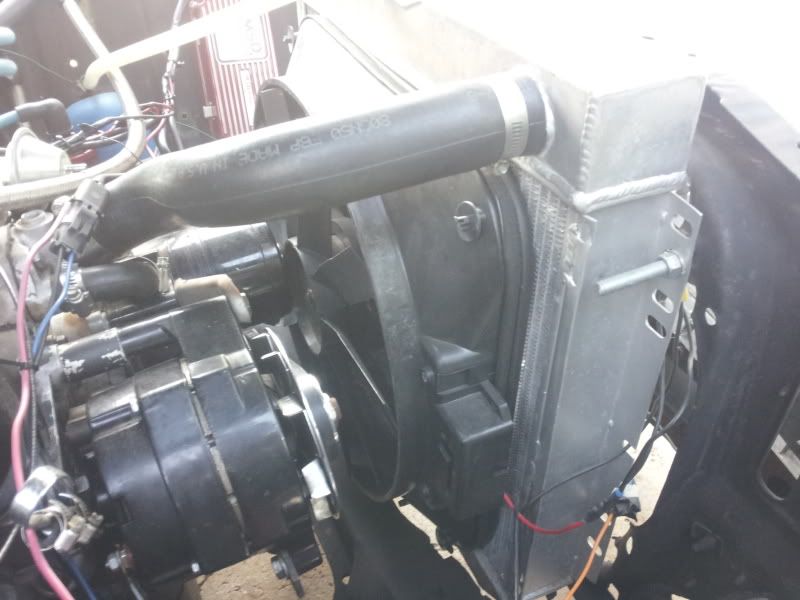

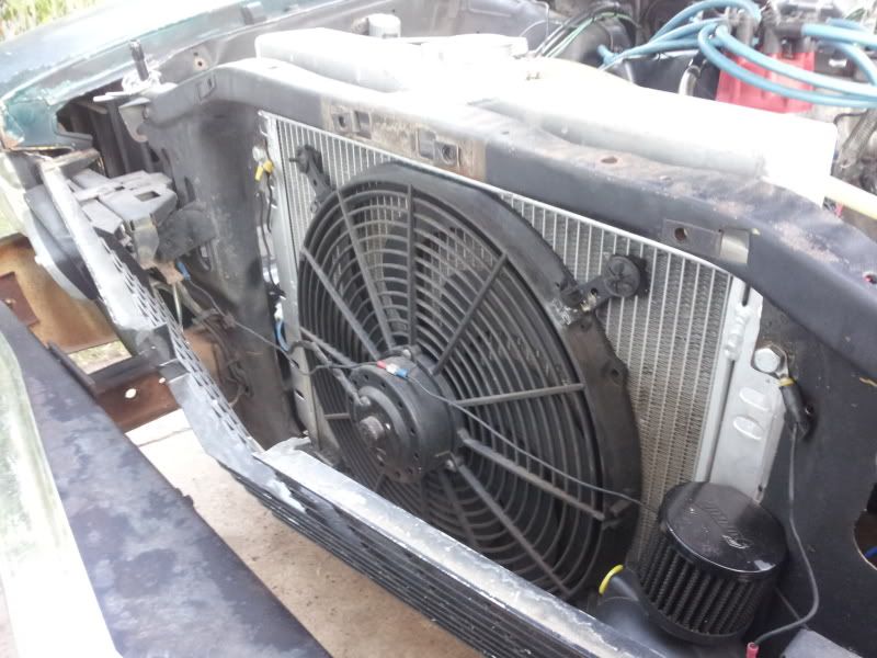

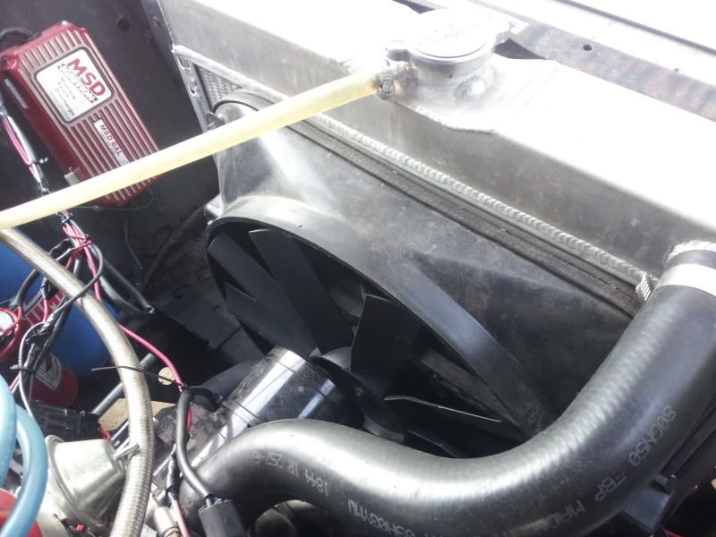

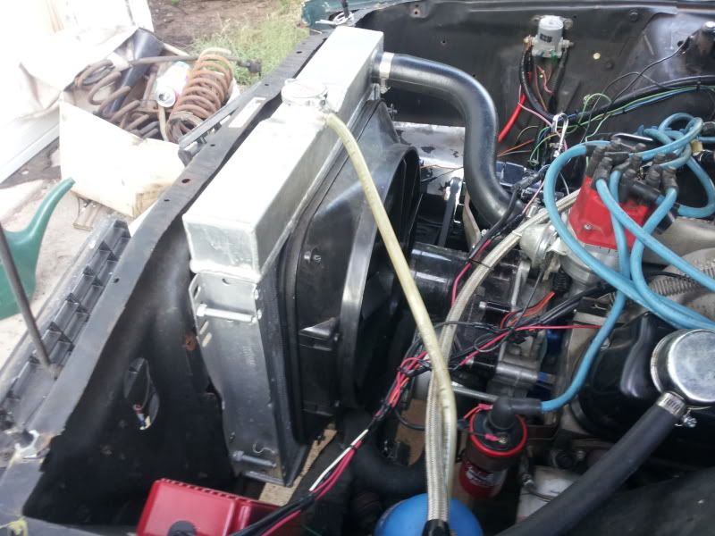

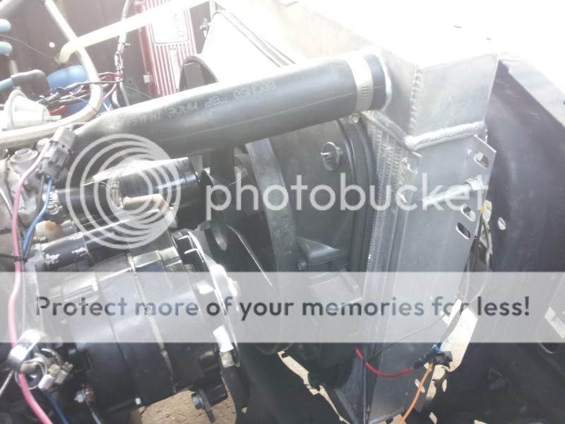

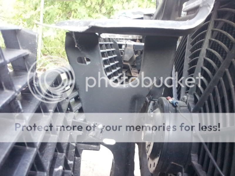

    Give me a few minutes ill go take some pics,1 fan is the 1 that came with the radiator the other is a summi brand fan part number sum-g4909.

    I would like to see that set up also... Always looking for options on running cooler.

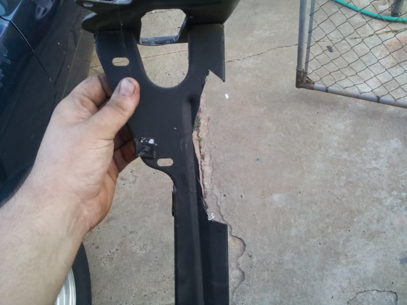

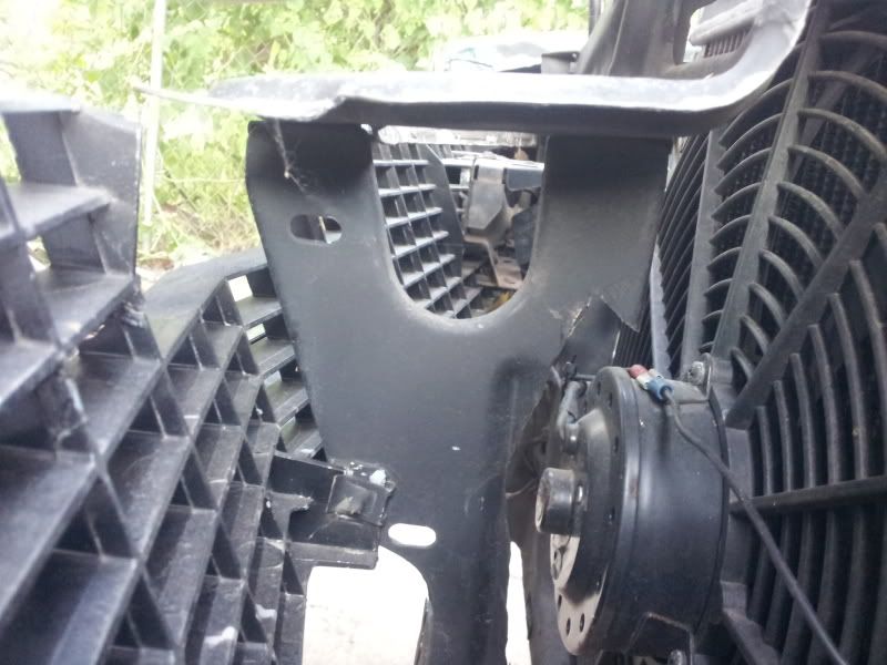

    Please excuse my wiring it needs redone lol

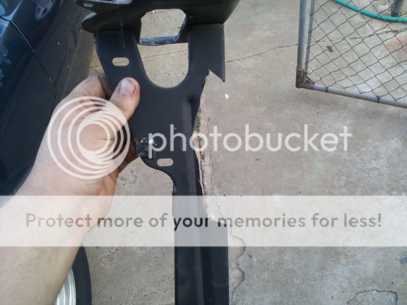

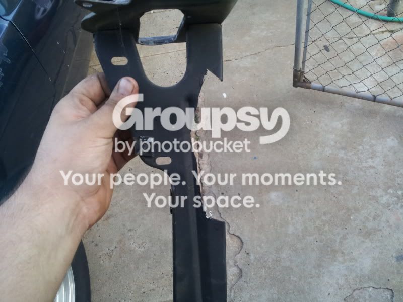

    Factory Hood latch support notched to clear the fan

    Wow..No wonder why your running Kool. That radiator is thick.(y)

    Thks for sharing the pix. I did'nt think there was enough rm to get that size fan in frt of rad. I got some ideas frm them..
