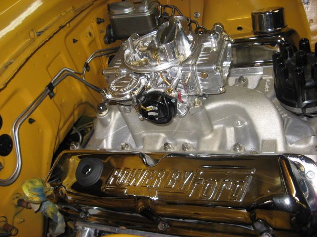

  12. Krazy Comet
    6,168
    1,298
    521
    Simple, easy to tune, Holley, no other for me...
    Were factory on many Fords, I've ran Holleys for years without touching them... And for the most part they are prettier than any comparably priced carb...
    (Yeah I've always been swayed by a pretty face)
    My 600 setting on a 8020 Weiand intake...
    baddad457 likes this.
  13. jasonwthompson
    jasonwthompson Member
    Mar 25, 2012
    891
    116
    Carrollton TX
    That looks squeaky clean Tom.
