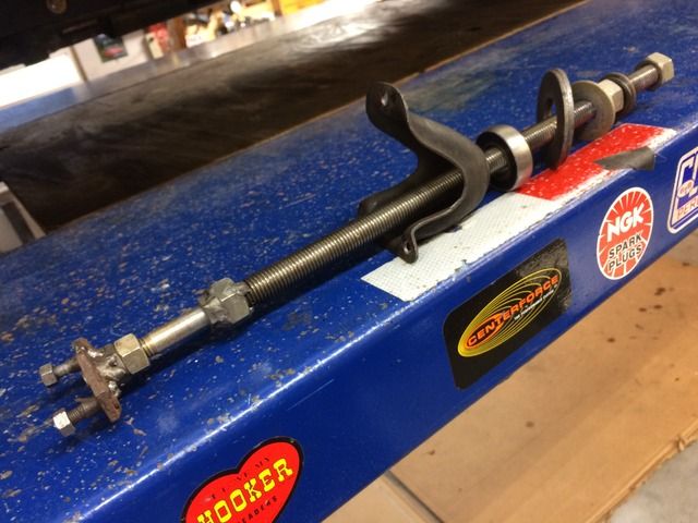

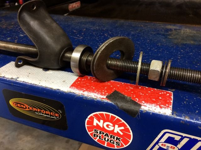

    Simple compressor tool can be fabbed ' from spare shock tower cap, old shock bottom and #8 rod. I still run a safety chain thru coil and take care...
    An old snowmobile bearing helps prevent binding
    haev fun
