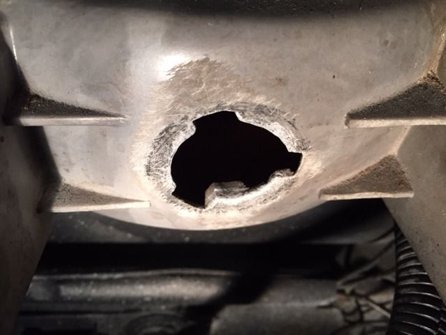

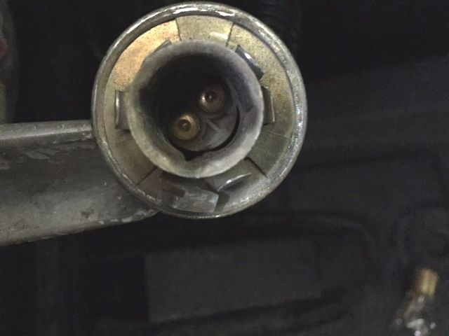

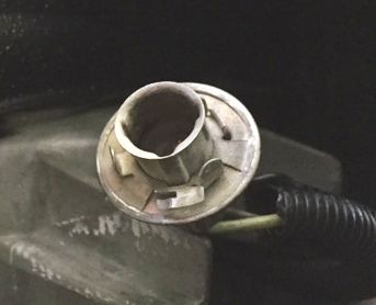

    Here are picts of the socket. It is metal. It 'had' 3 locking fingers, only 1 is left.
    Yes I can come up with a strap of some sort. Rather than reinvent the wheel, I'd like to see what others have done. Less work and headache for me plus it would be something that works :)
    IF it is simply the wrong sockets, then where can I get the correct ones?
    The back up light sockets are easy to rig since they are different. I can drill holes in the housing and insert a rod to hold them in. No problem there...

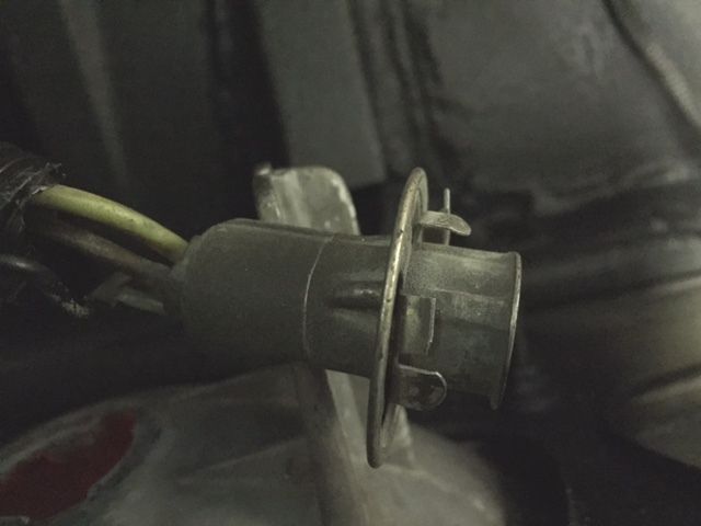

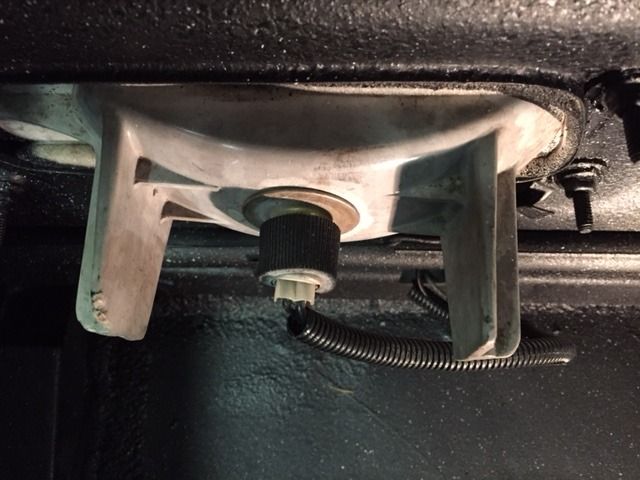

    I saw the Melvin reply after I posted the picts.
    Here are 2 more picts. One is the backup light housing, different set up, easy to slip a rod in there to hold socket in.
    The other pict is the tail light housing. All 3 bosses are still there.
