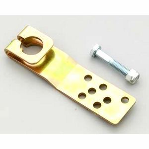

    After I finished installing the floor shifter, realized that the shifter lever on the tranny (c4) won’t work. It’s in a different position. Where do I get that part? Can I change it myself or the tranny has to be dropped and opened? Pictures and advice will help me a lot. Thanks in advance

    you need a floor shift lever. may get one from a Mustang parts shop. you can do it yourself but the transmission pan must come off.

    The auto column shift components are way more plentiful than the floor shift pieces. Are you using a factory type floor shifter, or is it aftermarket? Although I have never tried it, I have heard you can remove the lever from the trans and rotate it 180 and reinstall it. That will require you to drop the pan and possibly the valve body as well. However, you would have to do that anyway if you had the correct lever. If you go that route, there is also a seal you should replace as well. You may be able to buy an aftermarket shifter bracket/lever that attaches to the factory lever.

    Some levers on C4s can be rotated 180 degrees, and some can't. Just depends on the shape of the lever.
    If you change your lever, be sure to replace both seals, the one in the case and the one in the lever.

    Ok so I ended up getting some auto colum shift parts from another guy on the forum. Only thing, is I have no clue how to set them up. I bought the transmission linkage and lockdown linkage. Pictures below
    Any advice or a diagram would be great.

    if you change the shift arm be sure to hold the nut on the inside of the transmission.
    letting it rotate and bottom out on the case is a no no. saw one break the lever end inside the case. had to have it brazed back on...:yup:
    do change the...shifter shaft seals.
