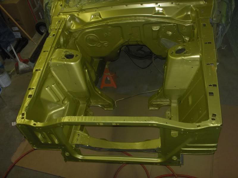

  8. Dave B
    This may help? My car has factory A/C.

    Thanks Dave.
    Somebody have a picture of a non AC car so i could compare?

    Pasc,if you want i will cut one out of my cars with a zip cutter so that you can have it welded in . You will have to wait a few weeks but if you pay for my time(1 HOUR) and pay the shipping ill send it to you by Greyhound bus with NO charge for the rad support,just let me know ,none have A/C.

    Got a picture of the car you will take it from?

    Thanks!!! :thumbs2:
    now i see where the holes everyone talked about are!!
