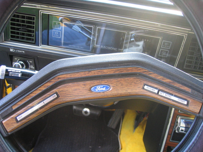

    That speed sensor will work for cruise. I used a similar set of cables with the sensor from a '70s Lincoln to add "factory" cruise to my Maverick. I now have most of the cruise from a late 80's T-Bird to interface with my EFI, but before that when I had a carburetor I had a cool bracket/actuator set-up that I found in a V-8 Mercury Monarch. All of the Ford cruise controls from the 70's thru at least the early to mid 90's could be used with any steering wheel with the cruise control buttons...so if you really want to you could grab the wiring harnesses and other parts from the junk yard and put Ford "factory" cruise in any Maverick/Comet. More work than most would bother with...but I like the end result. :)
    Yeah, I digress a bit...but anyway, that sensor works great for cruise. ;)
