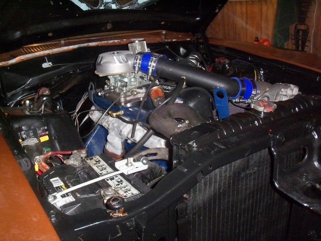

    I run a 170cid and two 250' small block sixes in varying degrees of modification.
    Enthusiastic engine builders , machinists and fabricators are using alternative inline sixes & eights', diesels Turbos, Superchargers and even hybrid setups and may soon become the real performance build challenge. Pricey crate or V8 build option is a simpler alternative but yields yet another Ford 302/C4 or GM 350/350 car in the shiny but monotonous show/cruise displays.
    The 250 has similar torque capabilities (rubber patch ability) as the 302 in stock trim. Fords' small block six inline was built for maximum MPG with least amount of emissions and Ford money spent on warranty repairs. With a littel inexpensive help the 250 can be re-tuned for maximum performance with some sacrifices on MPG and MTBF. Getting the questionable 'factory tuned' 250 to meet original performance specifications may release a lot of power hidden by poor tuning. The anvil strong 250 can take a lot of 'upgrade' power before needing big money extensive mods. Matching the capabilities of the torquey sixes to the drivetrain is the real key.
    Simple 4-Main Maverick 170 in my daily driver can accelerate and cruise at interstate speeds with ease with stock internals and stock camshaft. Modifications made to 170 are cyl head worked with back cut valves., V8 springs and .070 milling for @ 9.5 SCR. Completed with Hooker long tube headers and progressive 2bbl (H/W 5200) the torquey little 170 spins a T5 Overdrive tranny through 3.50 rear gears.
    I run a NA 250 in an early Comet with extensive performance mods including AMC 258 pistons, 274' cam, Holley 3X1 Tri-Port with 2300-4412 500cfm on a hi-rise tunnel ram or 3 Holley singles, dual out Hooker headers, extensive porting with oversize valves and extensive internal's beefing. With a 3.80 posi , T5-Z and traction devices the car is built for smoke at the burnout-box, launches all day and still driveit home with the 250 .
    My current small block six project is a Mav' 250 with a Vortech Supercharger. Stock block and cam with the head simply freshened but not milled yields @ 8.7:1 SCR with composite gasket. I first built the project with a Buick derived Turbocharger on the original 250 in the Maverick. With the T3/Draw-thru/Quadjet setup, I increased the boost incrementally until the piston lands broke off at @ 20PSI of boost. Current 250 SC blo-thru setup uses stock 250 internals with the freshened head and I keep boost to @ 10PSI max until I can afford forged pistons. I use a heavily modified (inexpensive) Holley 2300-7448 350cfm carb with a PV operating only with boost. Ignition advance control and stock exhaust with sensor for mandatory AFR gauge keeps detonation destruction at bay. Still have the 3.03 3OTT and 2.79 rear while completing engine tuning but can "lay rubber" in any length or gear.
    A stock 250 with careful tuning and mild carb and ignition mods and reasonably sound drivetrain is a good start to finding out how far - and how fast ($$) you want go....

    Upgrades to the top end only will limit the capability of the six but will enhance drivability without diminishing the 4.1's reliability. Since this old post, my SC'd 250 Maverick has had the forced induction tweaked to optimize 'capabilities' no matter how hard I've hammered it!. Nicer driving with '76 disc brakes, suspension lowered and alignment tweaked, and overdrive T5-Z tranny .
    With the better wheels and TA's, clean original bench seat interior, 'tucked' big bumper, and false Grabber striping ( PO done), real interest is often shared with ' builders' as they yawn past the endless 350/350 and 5.0/C4 clones.
