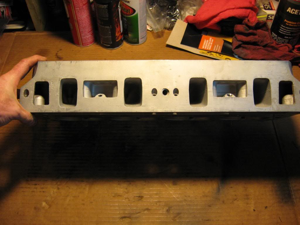

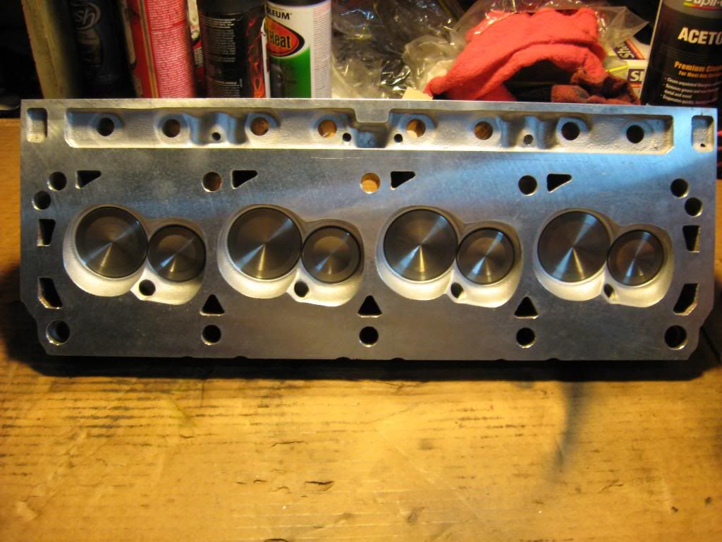

    While I certianly don't claim to know everything about small block Fords.. I know far more than my fair share about their cylinder head availability. Offshore and on.
    With that in mind.. I've never heard of a "twisted copycat head" and am having a hard time believing those valve angles are truly rolled and relocated as the originals were. All the offshore stuff is straight inline 20 degree.
    I would drop development work on my RHS stuff in a heartbeat for some twisted valve angles. Got any pic's you can share with us?

    Sure... but, these were all I could get before I just KNOCKED MY FRIGGIN' CAMERA OFF THE WORKBENCH!!! :banghead: This has not been my day.

    I hate to disappoint you but I don't think they are knockoffs, I'd bet those came out of the TF foundry... All mine have on them is a punched serial number and the TF patent is cast into the rough area by the valve springs, but it's weak...
    Maybe were sold to independent builder?? I know Ron Pond buys his castings from E'brock before they do any work to them and ID's them as his once he works his magic...

    Hmmm... good news, maybe. It'd be cool if that's what happened. That little number "2" and some washed-out casting symbol of some kind in the rocker galley is all that's on them.
    Eric

    I forgot to mention one of my heads has that same 2 but is slightly tilted(then maybe yours is as well), the other head has a 1 in same location...

    Decently priced find there if they need minimal amounts of additional work. Looks to be an early version of the stock port location TW head.
    The erosion around the water ports obviously means they're used so just be sure to go through em' completely before bolting them down. The guides should be checked for sure and I'd even go so far as to lap a valve or two just to make damned sure the valve job is on. Otherwise, something may be off and they won't last nearly as long before they need a full refresh. Good luck with it all.

    ya, to me they look like old , old trick flow castings. ive owned trickflows's in various forms forevor, and they look like some earlier castings.

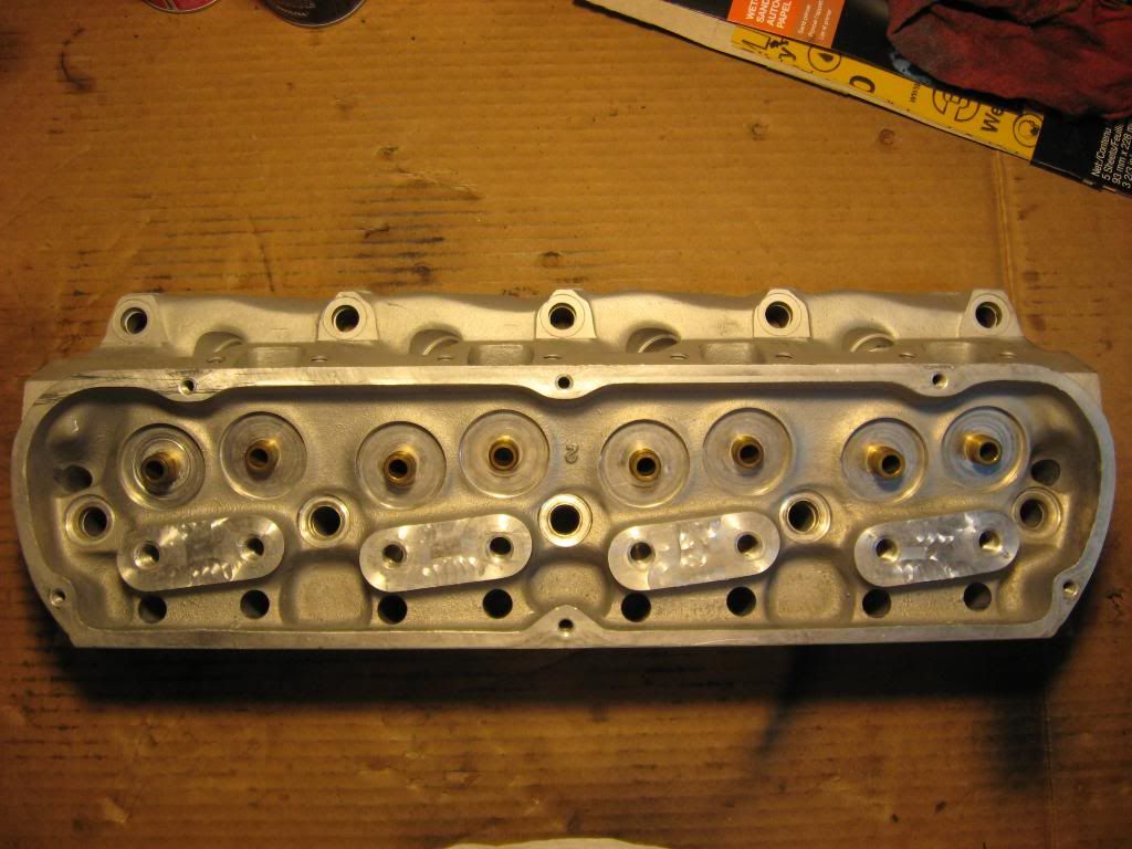

    New valve guides were installed, so, I think I ought to be ok there. However, I tried to measure a few valve springs for installed height and I found there is about a 3/16" gap between the bottom of the valve retainer and the 1.700" spacer guide my machinist made for me. The spacer checks out on my calipers, so, does this mean the valve springs need base plates, or, something?

    yep.. with AL heads you must have steel spring seats which also serve as spring locators. They can be had in either ID, OD, or both(cup style) spring locator designs.
    Plan on another .060 or so(obviously double check actual part being ordered/used) of added spring preload and total max lift losses. If the springs get a bit too tightly coiled?(overtaxes/overheats/potential coil bind in over-rev).. you'll need taller valves and springs(probably 1.8 height's). You can alos adjust final installed height with + or -.050 valve keepers to dial it in.
    It's been far too long for me to remember the valve length requirement for these older heads.. but I'm almost certain they were at least slightly longer than stock 4.910 length SBF stuff. Which usually meant more than 1.7 installed heights that some spring designs/ratings won't jive with. It always pays to check everything at least twice.

    AFAIK the TF heads use SBC length valves, I run the 1/2" longer(6.8") flat tappet push rods with them in my roller 5.0...
