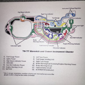

    Good morning all,
    Does this diagram appear to be labelled correctly? We are wanting to ditch the old circuit board and would like accurate definitions for the wiring harness connector.
    C & G

    I would think that would not be correct for all years.

    As labelled, the cluster diagram is for 1976 and 1977 Mavericks and Comets. We have a 76’.

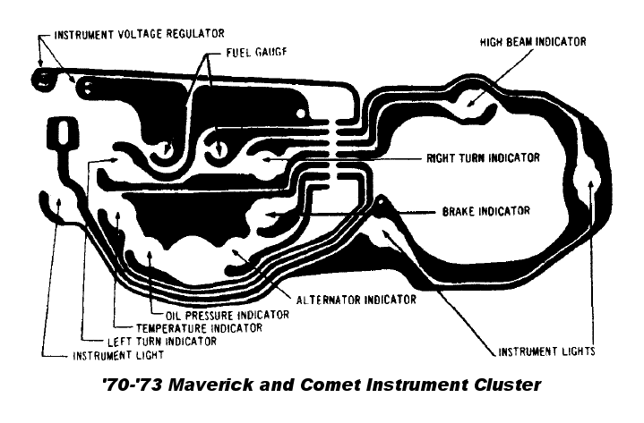

    Wish I had one for the 1970 Maverick. Got a turn signal indicator out, can't figure out why.
  7. NWMO_Maverick
    NWMO_Maverick Member
    Oct 29, 2016
    72
    Northwest MO
    1976 Maverick 302, C4
    Earl,
    This one is oriented just as you look at the gauges, but not easy to follow. The indicator lamps share a ground, so if only one is out you know it has to be the bulb or on the power side. As brittle as the "base" is on mine, it would be easy to do more harm than good checking it out. I am looking forward to having everything wired LED, but need to fab a new "base".
    C & G
  8. Earl Branham
    6,367
    201
    218
    Lugoff, SC
    Thank you so much for the diagram. I can remove the cluster, as it is in really good shape, not powdered, and troubleshoot it. This will be a big help. Thanks again!
