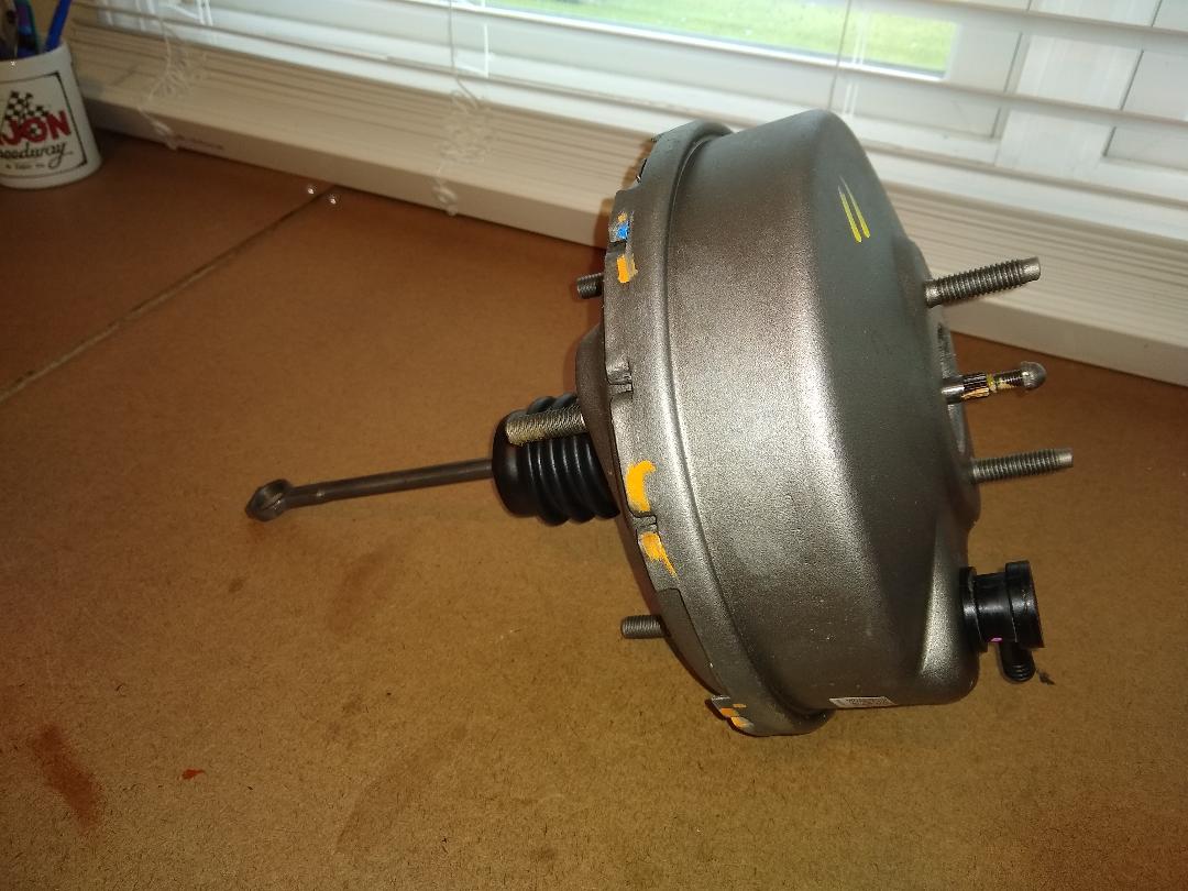

    And here is my new brake booster. For some reason, when it seems that no other parts source in country either can't get one of these at all, if they can get one, it will take eight weeks to get to me, yet O'Reilly Auto Parts got this one to me in three working days!
    [​IMG] [​IMG] [​IMG]
    I have no idea why the photo replicated itself three times and won't let me delete any of them. But, at least you can get a good look at it! :D
