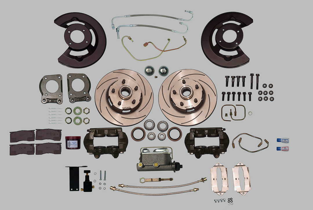

    so im looking at a ne break kit. I see a 4 and a single piston kit at discbreakswap.com ... Single here CLICK single piston SWAP2.3 $738 vs 4 piston here CLICK 4 piston SWAP1.4 $694...why would I not go 4 piston when its cheaper? 4>1
    Ive emailed them, so lets see what they say

    Mainly cheaper because the four piston kit bolts to original spindles.
    The booster M/C combo shown will never fit into a maverick.
    I have the four piston kit on my Fairlane, even without power they are very good.

    If you click on the image link for 1.4 it shows it without the booster. So looks like this is the winner

    I got this back from them.,.
    The 70 Maverick brakes are like 70 Mustang , so the SWAP.1.6/M/AS.70 or SWAP.2.4/M/AS.70 are applicable. The 1.6 will mount to the cars existing spindles and feature 4 piston calipers. The 2.4 is the original type for 70 Mustang and uses single piston calipers. Both are excellent.
    The AS.70 part of the part number indicates the inclusion of a $31 distribution block adapter kit which is necessary with 70 and up models
