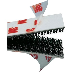

    This is what I plan on using.
    3M Velcro Dual Lock Heavy Duty
    Once secured, simply press the two pieces of dual lock together and their mushroom-shaped plastic stems interlock with an audible snap to make a fastening which is stronger than Velcro.

    The only issue I see with done that way is the distance the panel will stick out from the door. I like the idea though Velcro is some tough stuff

    They have it at Home Depot take a look and there is recessed areas that may pull in panel more that the pin locations.

    dgodding, Thank you! I wasn't aware of that product, I'll check it out! I realized a plastic fastener won't work because the metal clip goes further in than the plastic, so the panel wouldn't fit right. Somebody ought to invent an off-set plastic clip--oops, if any of you invent it, I get 35%---HA!

    Renton5.... I have used this for fire Extinguishers in garage. holds tight with heavy objects.
