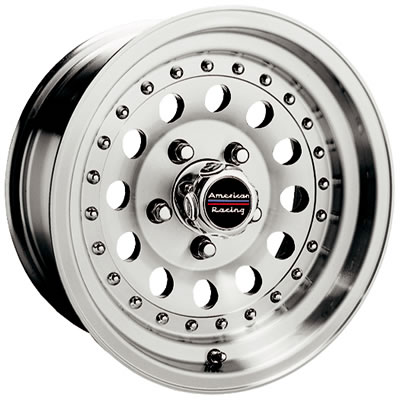

    these are the rims I have right now: American Racing Outlaw II, 15x8 5lug with 3.75" backspacing. With the 4 leaf springs I have a little more room so I could try a little bigger tires but don't want to rub.
