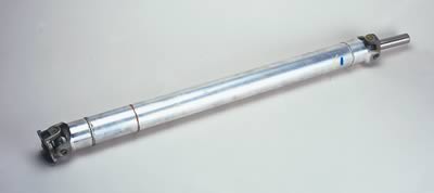

    I ended up ordering this drive shaft which is a Ford Racing product for the 70-2004 mustang as mentioned above. I don't have the budget right now to purchase a mark williams product so hopefully down the road I can make the switch. If this doesn't fix the vibration I'll chase the pinion angle.
    http://www.summitracing.com/parts/FMS-M-4602-G/

  7. MavMark
    MavMark Mega Modifier
    779
    Detroit Area, Michigan
    I did this swap a couple weeks ago, with that exact model Ford Racing driveshaft. I used this U-joint to connect to the 8" trac-loc rear end in my car:
    http://www.summitracing.com/parts/FMS-M-4635-A/
    I changed the rear u-joint myself with a u-joint changing tool I got from Harbor Freight. It was a little challenging getting the drive shaft in the car because of it's larger diameter, but I was able to do it without having to drop the exhaust. :)
    So far, so good...the driveshaft got rid of almost all of an annoying vibration the car has had for years...and a cheap replacement trans mount from Rock Auto got rid of the rest. ;)

    here is what I started with today
    here is what I ended with :)
    Drives really well, the vibration I was having is a little better, not fully gone but hey, improvement counts
