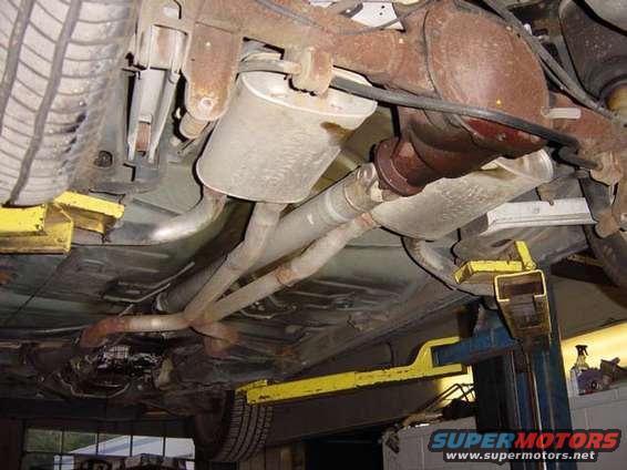

    I need to figure out something that will fit through here...
    By the way, that rusty chunk is a piss-poor installer's version of hanging side pipes.
    I am not quite sure how much that Caltrac setup moves, so I need to be careful how much space i leave between it and the exhaust pipe for travel. i have been looking at flattened oval tubing that may fit in there, but it is way expensive and still not sure if the cal-tracs will hit it on launches.

  10. maverick75
    9,018
    Like this?
  11. Mavman72
    Pretty much...Yeah. The subframe connectors Scotts useing may be a problem though.
