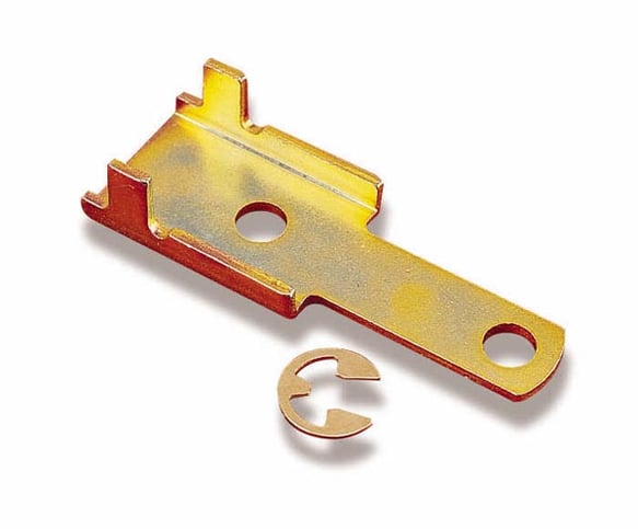

    I just got the part #8011 in today. Not much to it really. it's and extension and a nut and bolt with washers. no real way to attach it to the kick down rod unless I use a nut and bolt through the rod and the extension plate. Is that how it is supposed to attach? if so pretty shoddy "kit".

    That is all it is and all it needs to be. Pretty simple and cheesy isn't it?

    That is just the rod extension, what you need is the Ford kick down lever kit that attaches to the throttle linkage on the carb.

    where can I get that?

    Looks like part #1483 but I have to wonder if all the eddy carbs take that same linkage?
    Might be a good time to call the manufacturer directly to make sure.
