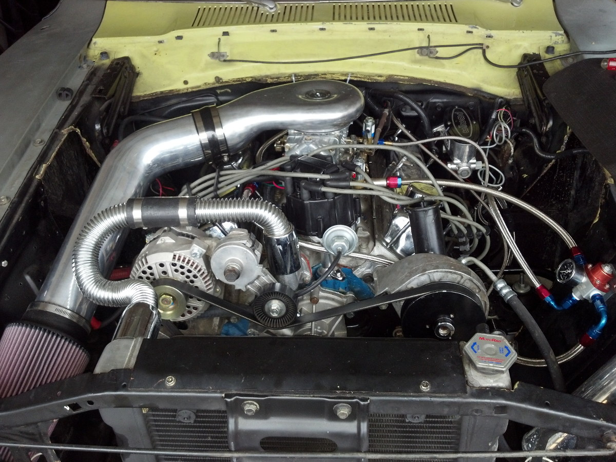

    Anyone give me some insight as to what radiator hoses they used to connect an EFI 302 to a stock radiator? I have an upper hose from an ‘89 Mustang. It looks like I will have to cut it in the middle and use a coupler to shorten it unless someone has a better solution. As for the bottom, does a stock 302 Maverick hose work? I don’t want to order one only to find out it does not work.
    Other than the bright blue ones made by Goodyear, does anyone know of a source for silicone hoses that will work?
    Thanks,
    Micah

    I'm running the serpentine belt and the hose has to get over the tensioner and alternator.
  4. Jamie Miles
    Send a PM to the member injectedmav and ask him what he used. This is a pic I took of his car at a Maverick meet a while back.

    I sent Injected a message but have not heard back. Anyone else happen to know what I need to use?

    Alright, I think I have this figured out.
    I tried the Bronco II, Napa #NBH7470, and did not like the fit. I tried something that the early Mustangs were using but did not like it either.
    After some messages with Injected (Jason), it did not appear as though the lower hose from a ’97 Explorer was not correct either. I then looked at the upper hose for the Explorer, Goodyear 62834. I just stuck it on there and it looks like it is a match with the photograph of Jason’s car.
    Thanks to all. I hope this helps someone in the future.
