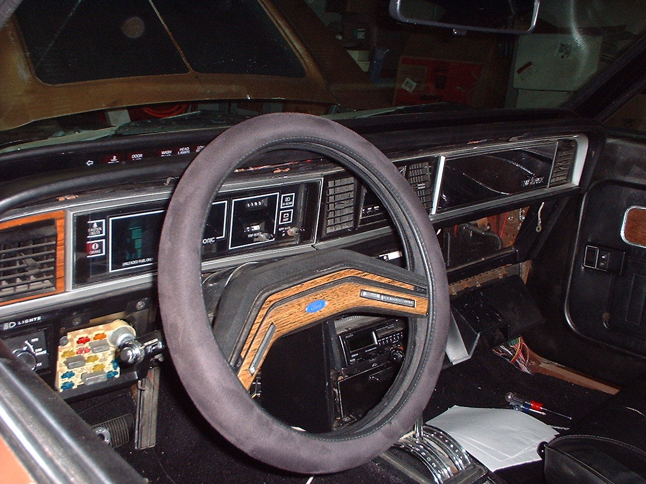

    I cant really tell ...but are those square gauges???

    Good catch , Grabber-1. Those are indeed square gauges. I installed an electronic dash from a 1980 Thunderbird in my Maverick. Why did I do that? 'Cause I thought it was cool... :)

    Here is a pic to give you guys an idea of what the dash looks like..I know that will be the next question :)
    Again, this pic is well over a year old and it now looks lots better and more finished. (Just ask people who saw it at the Roundup..in fact maybe someone has a better picture of it that they can post...)
