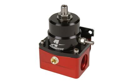

    we were mocking up what we have so far,
    bryant has these fuel rails
  3. mashori
    mashori Member
    Apr 21, 2006
    3,630
    San Diego, Ca
    1971 V8 Maverick
    at the shop we have an spare 302 sitting around and I took off the old carb intake and put this one just for mock-up to see if it will clear the distributor and looks pretty good
    the plan is to put a Y fitting in front of the fuel rails and then run lines to the regulator in the back of the fuel rails and a return line to the tank
