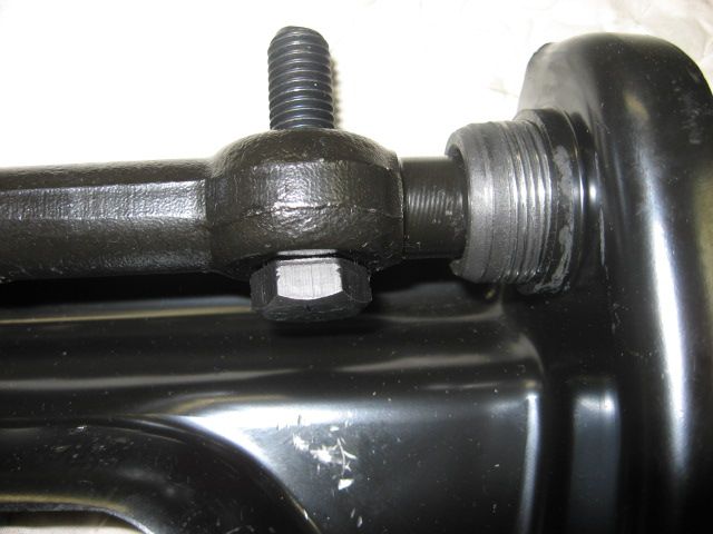

    So, rotating the shaft will move the upper arms rearwards? That's good to know! I was thinking earlier of putting some shims on the front bolts to make it tilt rearwards. I'm not sure if it would work. lol

    Yeah with the bolts pressed out, the inner shaft can be rotated probably 1½-2 turns in either direction... Assuming it's centered of course, one of my new ones was off center when I received them...
