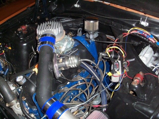

    HEI/DSII on Supercharged Maverick 250
    [​IMG] . [​IMG]
