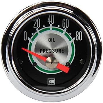

    Any analog gauge will work. If the gauge manufacturer has a sending unit, you may want to use theirs instead of a factory one. I like the Stewart Warner Green Line series as they look similar to the factory gauges on the earlier models.

    These look great, I will definitely consider these!! Thanks!
    what size thread do I need for the sending unit to fit my car?
