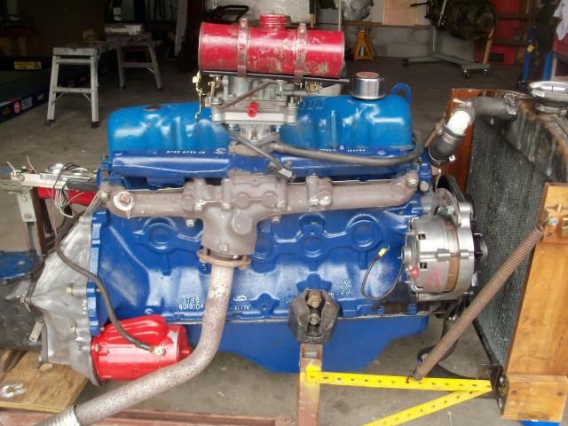

    ... how can I tell which one I have, would looking up the vin # tell me? Or somewhere on the engine? - - 200's have 3 bolt water pump...250 has 4 bolts
    The Maverick 200 and the 170 will have the starter ABOVE the oil pan, The 250 will hang BELOW where the oil pan to block meet.
    250 with low mount starter:
    The 200 will have 5 freeze plugs along passenger (right) side of block, 170 will have 3 freeze plugs

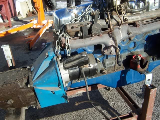

    200/(170) with high mount starter:
