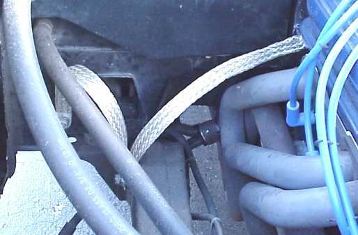

    Just asking, what is a "braided strap" and how do they look like, I need som better ground as well over here!!! :tiphat:

    looks like that stuff (sleeve) you buy at the parts store to make your hoses radiator, heater hoses look braided. (y)

    Oh, that head problem! Yes, Mr. Frank is correct - again. :rolleyes:
    Recommeded by "The Book": Two - one from each head to the firewall. One from the front of one head to the engine "frame". One from the battery (in trunk) to "frame". I suppose a starter ground wouldn't hurt either.
    This one looks longer than necessary (the shorter the better, I'd say) but you get the idea of what a "braided" ground looks like now. There are shorter, narrower grounds available at your Vato Zone cheap.

    I was going to say they look like chinese fingercuffs, bot with eyelets on the ends :p
