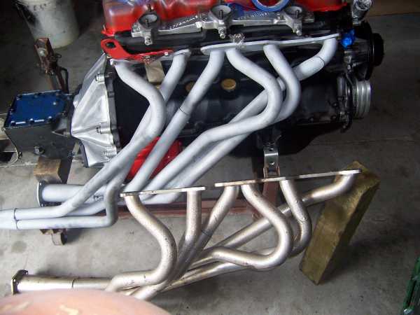

    So I have a question is there any companies out there in the United States that sell headers for a i-6 250 that will not charge me $1,500.
    The 250 Header needs very different bends to clear the SBF 302 V8 bellhouse , Starter and C4/Toploader clearance and mounts.
    The Ford small block six 250 (4.1l) is a factory stroked version of the Falcon/Mustang 200 (3.3l). Adding almost 1" to the crank throws and raising block height almost 2".
    The 250 Maverick needs a tube set unique to the 250 (4.1L) AND fit the Maverick. The Ford 200 has many manufacturers of inexpensive headers. Modifications to 200 app' headers are possible but unique Maverick application is unusual and limited.
    Only proven - Maverick application for 250 4.1L - Headers i've found are the Hooker #6601 Super'Comps 'Long Tube' .
    The more common Hooker 6602 fits the Ford small block 200 from 60's through 80's.
    Hooker 6601's on small block 250' and set Hooker 6602' for 200 3.3L applications. 6601 is Maverick application circa early 70's.
    tight enuff?

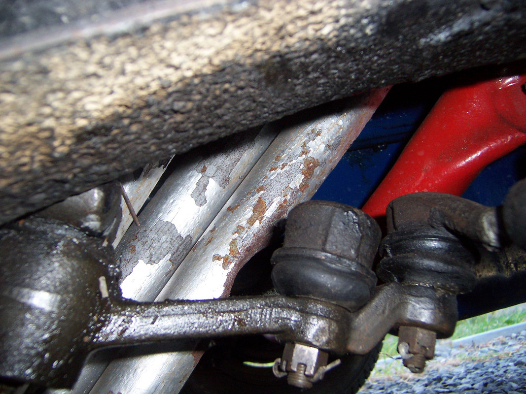

  8. Krazy Comet
    7,575
    2,338
    That looks like mid '60s Falcon, Fairlane, Comet steering.
    Maverick/Comet has better steering linkage configuration.

    "... looks like mid '60s Falcon, Fairlane, Comet steering."
    good call ,,, '61 Comet uses Maverick: Spindles, LCR's modified with Maverick Camber links, frt sprgs, 8"-3.80 diff', Tri-Power 250/4.1 six. AND Hooker 6601 Maverick application long tube dual out Super Comps'.
