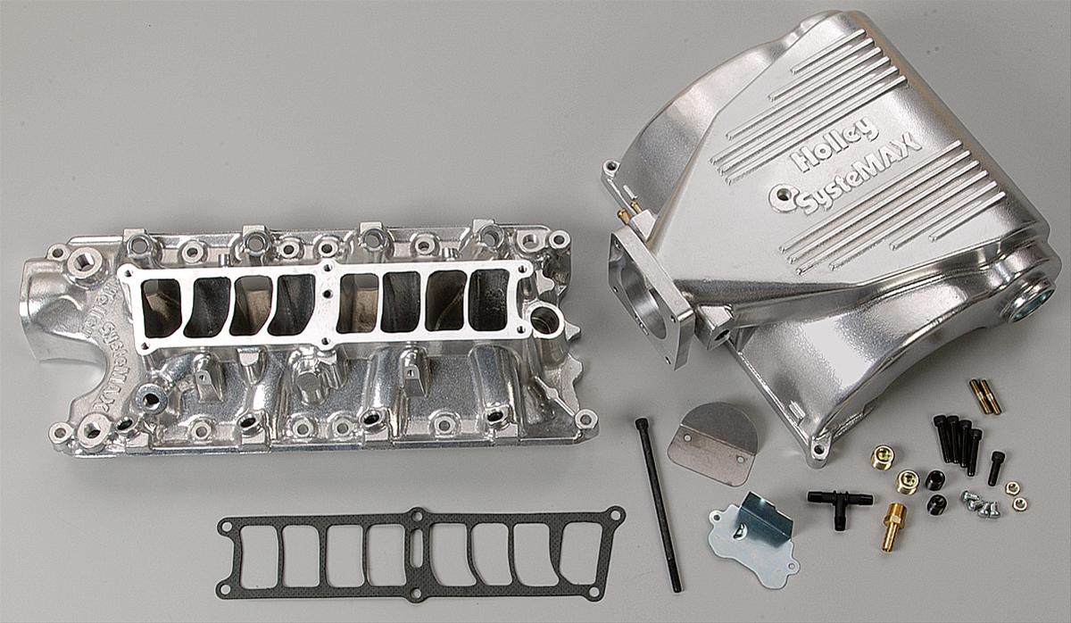

  9. RMiller
    RMiller My name is Rick
    Dec 12, 2009
    4,132
    1,160
    538
    Kennewick, WA
    1971 Maverick Grabber
    This is the one a guy I know is running on a stock truck lower. Not sure if the sell them separately or not though.
