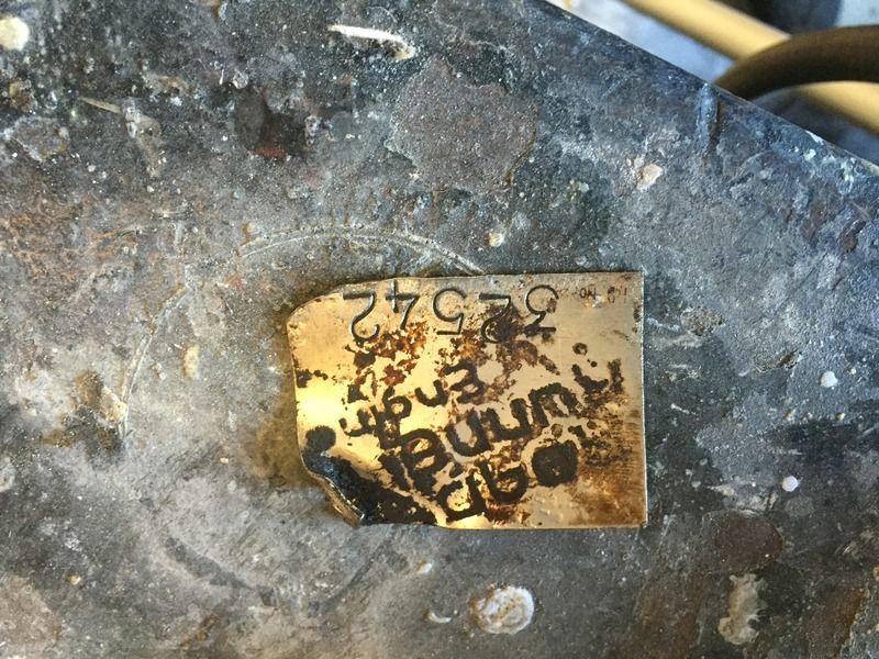

    Tried the light under the valve with no light coming through. Heads didn't look too bad from the outside. Bottom end was rebuilt at some point so it's .030 over. Found this tag on the block.
  12. 7D2 Grabber
    7D2 Grabber Member
    Apr 10, 2009
    999
    Northern CA, Bay Area
    Road Runner Engine i.d. 32542
