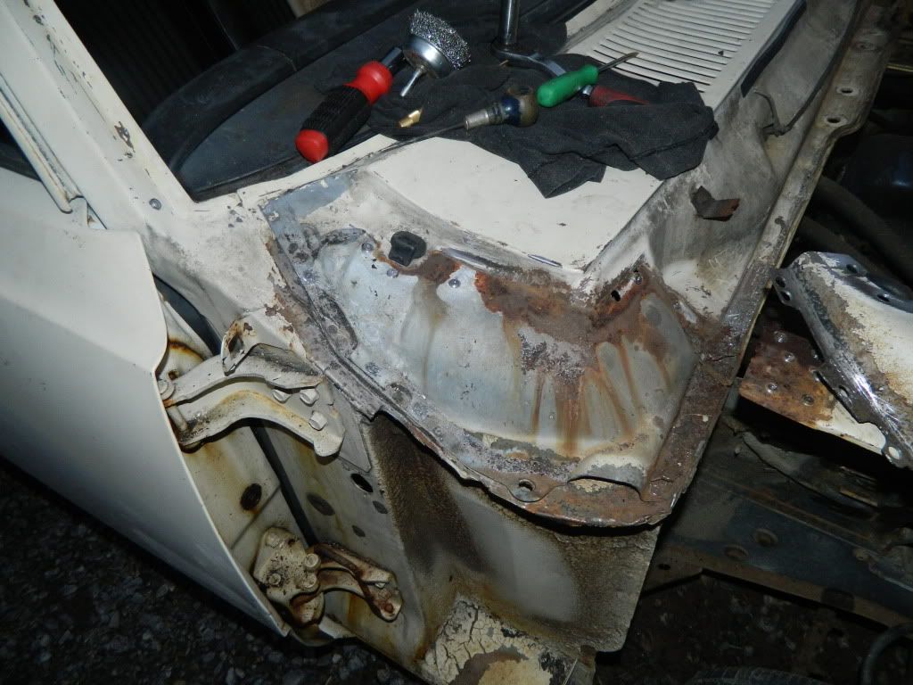

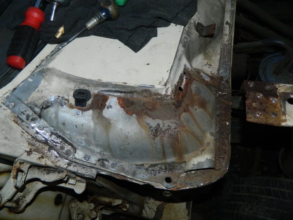

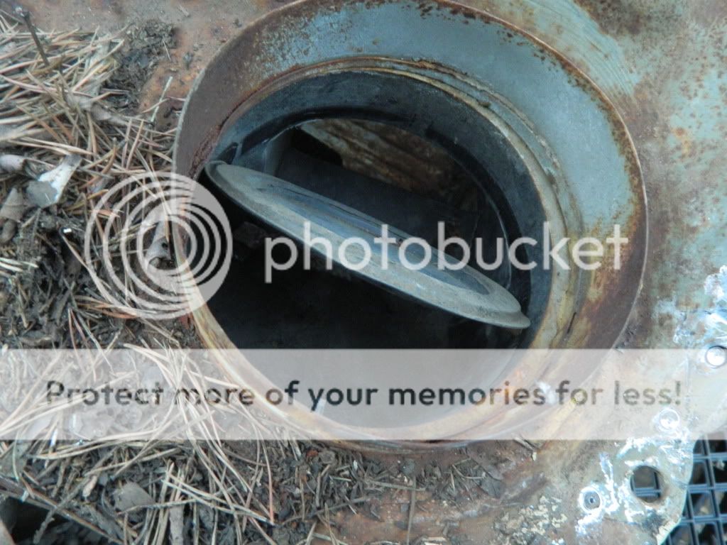

    Well..... It has begun. LOL. Cowl Repair in progress. Here are some updates:
    This was all I was able to get done this weekend. I was satisfied with how much I got done considering I spent most of the weekend chasing down parts.
  2. mav1970
    Nice progress for 1 day - you will be very glad you made this repair - I know I was :clap:

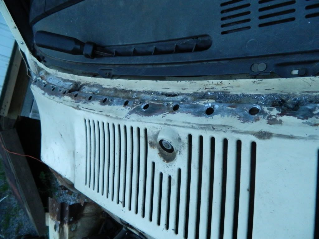

    Thanks! First time doing a cowl repair. At first I felt like I was messing something up. Soon as the first spot weld popped loose, I was in the groove, LOL. Yeah, it's been eating at me. I'm dying to get it fixed so I can get on with fixing the floor pans. Hoping to have the cowl removed completely next weekend.
  4. mav1970
    I see, in at least one hole, where you cut all the way through with your spot weld cutter. I have a bunch that went right on through that I will have to deal with. I haven't welded my outer cover back on yet because I ran out of Rust Bullet back in the fall and I was going to wait to order more once the warm weather came back again :)
  5. ResidentEvilRoc
    ResidentEvilRoc Got bit by the HP bug.
    Oct 4, 2010
    602
    Rogersville, TN
    1973 Ford Maverick
    Yeah, I only managed to do it to one. One more than I was hoping for. Now I'm getting a "feel" for it, and know where to stop. I've heard lots of good things about Rust Bullet. Por-15 as well.

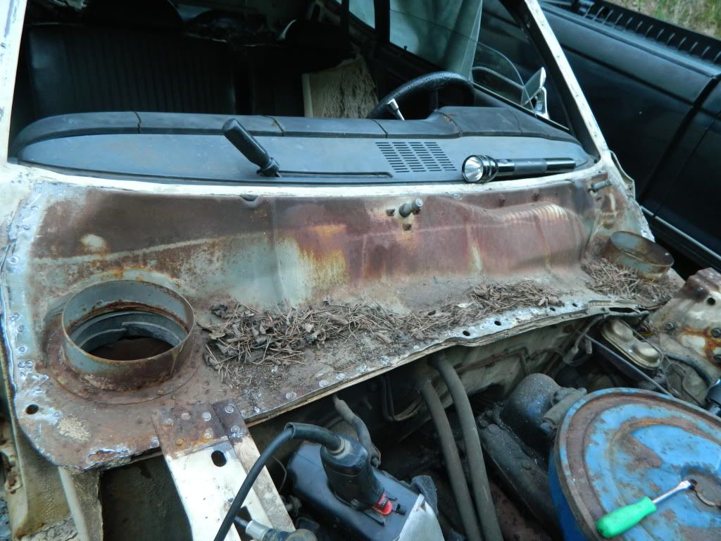

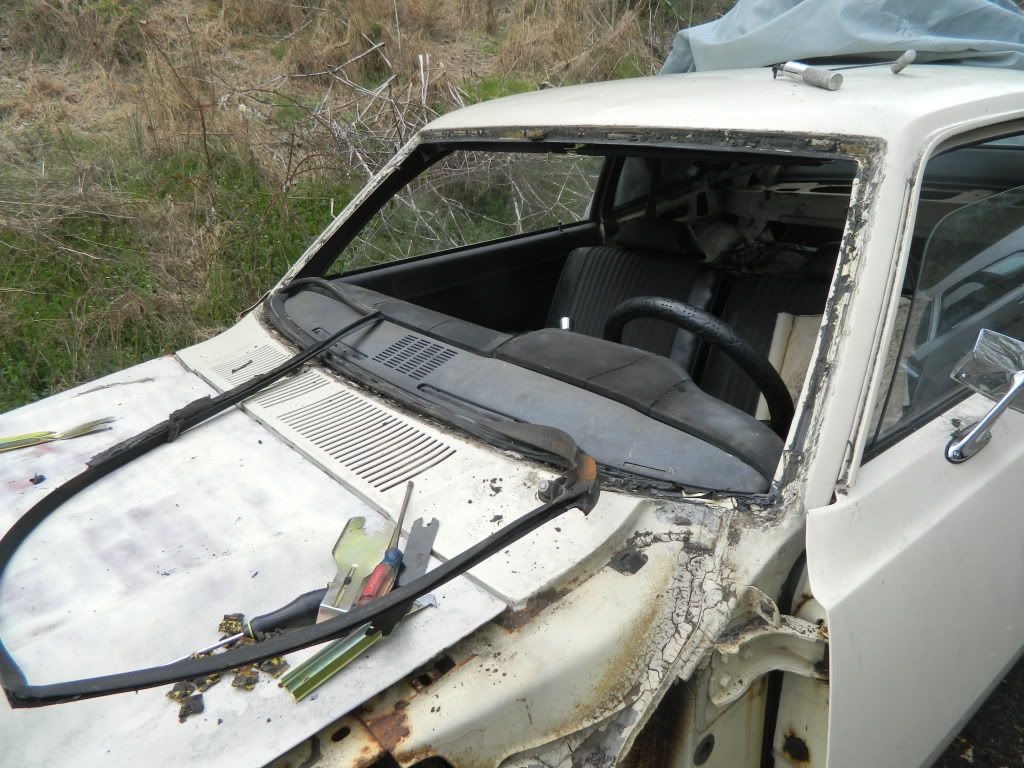

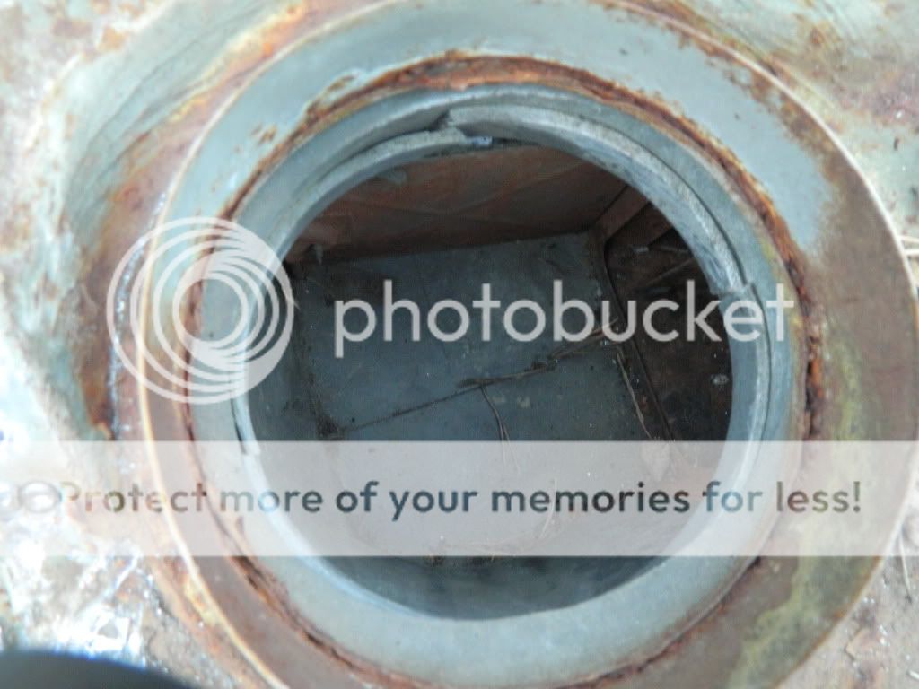

    Well, I wasn't able to do anything to it last weekend as I had some BAD troubles with kidney stones. This weekend has been a different story. Got quite a bit of work done and still have all day tomorrow to go. The cowl is finally cut out and awaiting repair. Here are some updated pics:
    Hopefully working on cutting out the floor pans tomorrow. More pics in a day or two.
  9. mav1970
    Doesn't look that bad - your damage looks to just be in the rings but you still needed to go this far to find that out. I took a wire wheel in a drill and cleaned the entire cowl - the wire wheel exposed a few pin hole spots that I would have never seen with my eyes but now is the time to find it all :thumbs2:
  10. ResidentEvilRoc
    Oct 4, 2010
    602
    Rogersville, TN
    1973 Ford Maverick
    Yeah, That's only the real damage. Which is enough, LOL. That's why a few spots in the floor pans are gone. I'm glad the job is over with. TONS of spot welds. Overall though, it wasn't nearly as bad as I thought it would be. I am glad I did it though so I can make sure it won't be leaking any other time in the future. One less thing to worry about.
