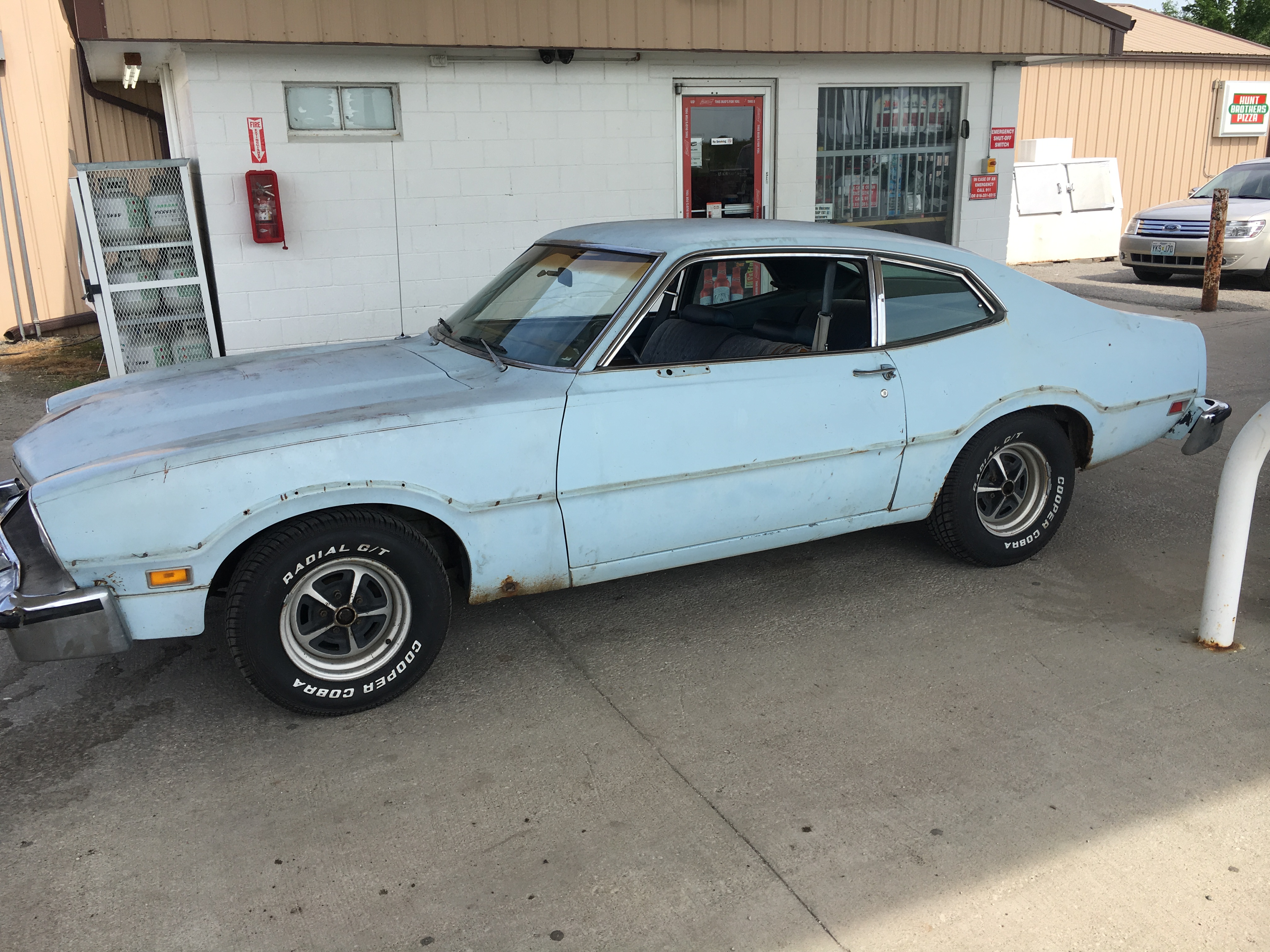

    1976 Maverick 302, C4
    Goes down the road nicely, but doesn’t hold an idle very well yet.

    That memorable first trip to get fuel.....lol....about a year ago for me. Keep at it.
