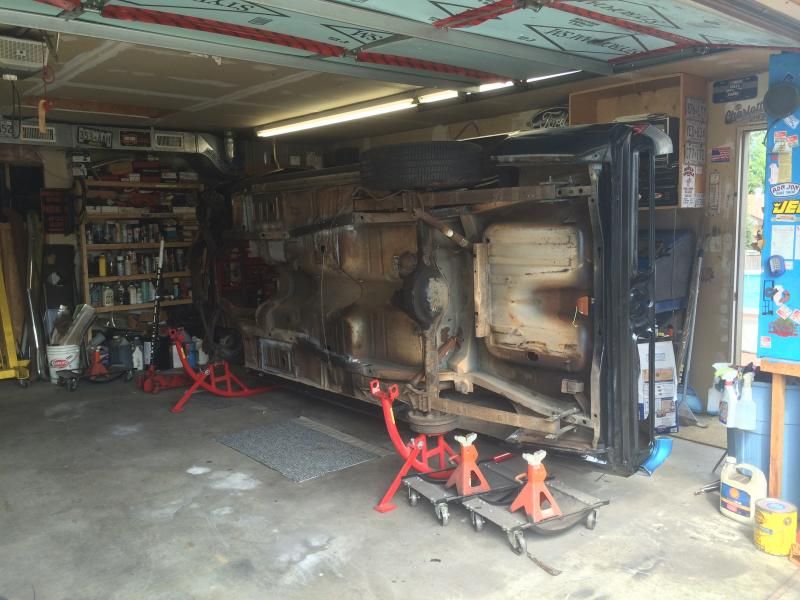

  1. Dave B
    On it's side. :D
    Time to start working on the underside.
    Allen Small, Mavman72 and Tannersg1 like this.

    i hope you emptied the axle housing :scratchchin:

    That's awesome. How far are you going with the under side, scrape & paint, undercoat, sandblast etc.? How much stress does that put on the leaf springs & shackle bushings?
  6. scooper77515
    Why not completely upside down? Then you can sit on the bottom and work down between your feet, and any painting you do will settle down, and not run.

    where did you get the pivots they look very interesting. How much effort to turn it that way?

    Paint doesn't run when you do it properly. I cleaned pretty much the whole underside tonight, with scotchbrite, it still has most of its original paint.
  10. mav1970
    Makes a world of difference when you can sit on a stool and work on the underside of your car - nothing falls in your eyes :thumbs2:

    i saw this scrolling through the section and was like 'woah woah woah' lol but glad to see its a controlled roll! and thats real convenient!

    Looks really good, Dave! What did you use to lift the opposite side of the car?
  14. Dave B
    Just my engine hoist, once it gets about half way, you can just push it, the rest of the way.
