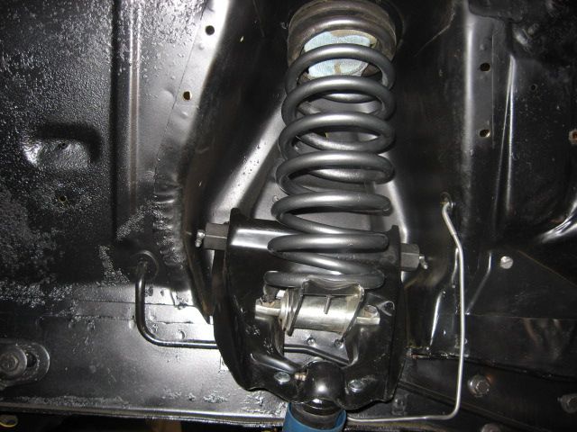

    Its been a while since I've looked at a stock spring but that cant possibly be right (original picture). Once you check the uninstalled height and find them to be the incorrect spring, be sure not to just cut to length. Its likely also the incorrect spring rate. Send them back for the right part.

    Here's pict of mine taken back last winter with orig spring reinstalled...
    I've also removed air cond compressor but will be reinstalled... Still I'm surprised mine sets so high, allowing for some ageing, would thought orig springs would be just about perfect...

    Pulleys! No, I rented one. Now it is clear I will have to buy one since this will be trial and error. I got my compression tool today and I just pulled one out after about an hour of scary high risk work. The uninstall height is right (about 16.5 inches). I will start cutting! Going with 1 1/2 coils to start.
