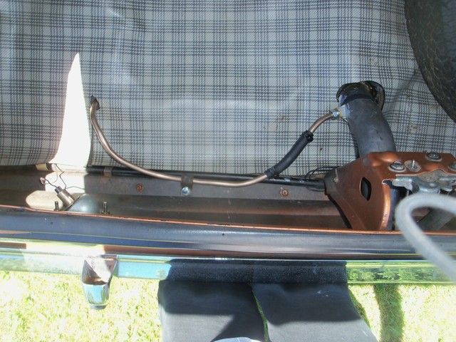

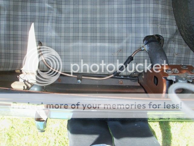

    I set up my '74 Maverick with a Supercharger and needed a return for the boost ref'd regulator. I considered using the vapor return but isn't built for any pressure. I plumbed a 3/8 return line following feed from tank and use the filler tube in trunk to add retun port.
    have fun
    ... if 'PhoBu' alows:
    [​IMG]... [​IMG]
    (Alum safety panel covers it)
    have fun

  12. BBMS18
    BBMS18 Member
    Aug 5, 2018
    890
    527
    236
    Grand Rapids, Michigan
    75 Comet
  13. 71Mavrk
    71Mavrk Member
    Jul 27, 2011
    1,206
    423
    238
    Nevada
    Nope. There is just enough of a gap to run the lines through.
    The advantage of keeping the vent line allows you to easily fill the tank without fuel backing up the filler tube.
    Micah
    BBMS18 likes this.
