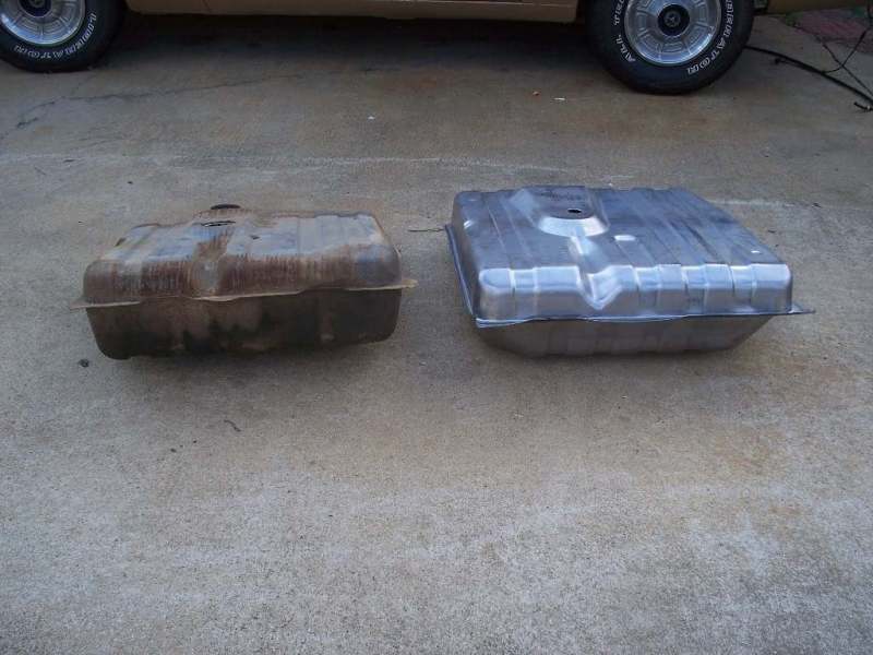

    So my question is, is there an easy way to tell 17 vs 19 gallon while the tank is still on the car? Maybe by measuring the outside dimensions?

    19 gallon on left...74 tank on right. Notice the kick-out on left side of newer tank

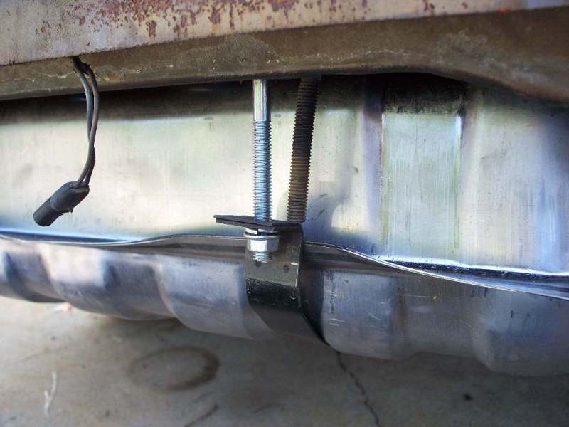

  4. fullcm
    fullcm Doug
    Jun 10, 2017
    Michigan
    74 maverick
    A picture is worth 1000 words. I definitely have the 17 gallon tank. Thank you for the help.

    I just realized, it looks like the sending unit can be replaced without even needing to drop the gas tank.

    Thanks so much! So the tank on the left is the original 19, and the one on the left is aftermarket?

    Tank on left is what came in my '74 from the factory...tank on right is the replacement tank
