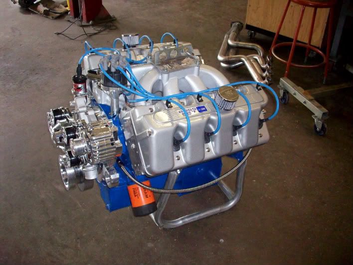

    Maverick 1973-Pure Muscle.

    Isn't it? I wish it was mine!

    And mine!:burnout:
