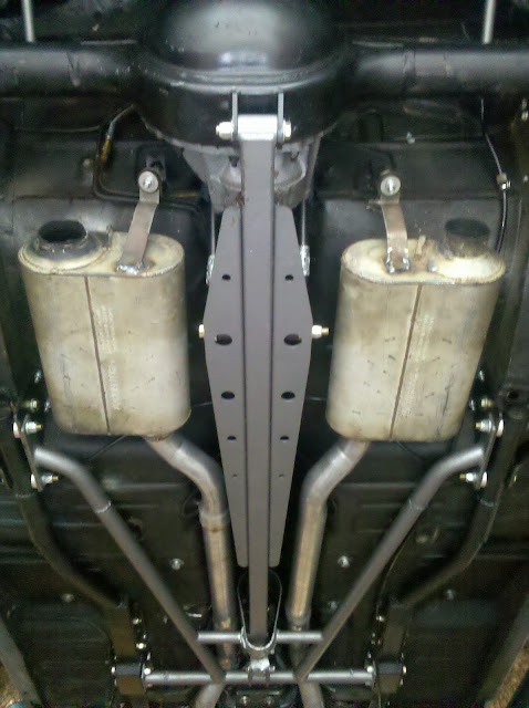

    Another problem came from clearance with the rear end. I thought I would have enough but after thinking through it, I decided not to take a chance. I really didnt want to cut into the floor of the car but there was no other way. That is after all the reason I went with this suspension design.

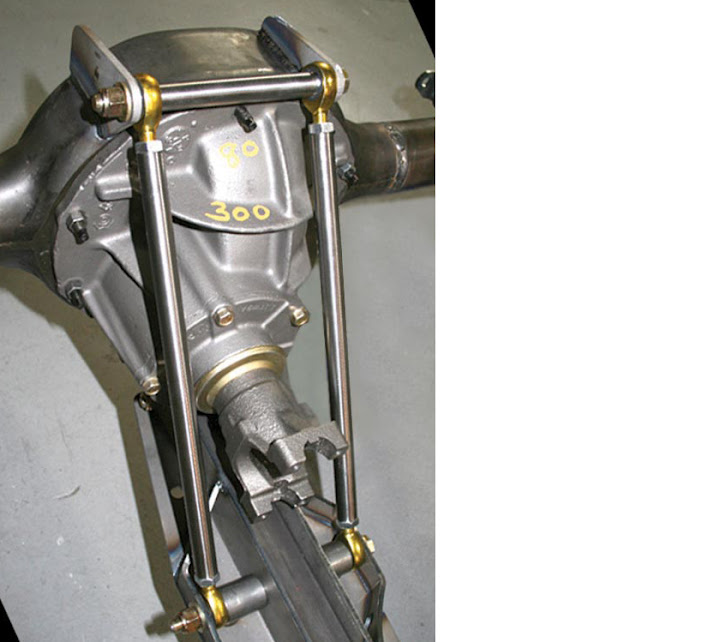

    just looking at what youve got going on with your custom suspension. what are the two arms coming off the top of the diff for?
    it looks like to me that you are running a 4 link set up with a torque arm. that will cause a bind. am i just not seeing this right?

    Thats actually the pinion support/angle adjusters. They attach to the torque arm just forward of the pinion snout. Thats the part that is giving me grief. At the top end of my suspension travel they come into contact with my floor pan.
    I ended up cutting 2 holes in the rear seat pan to make room.
  9. Bryant
    ah ok. now i under stand and see the light.

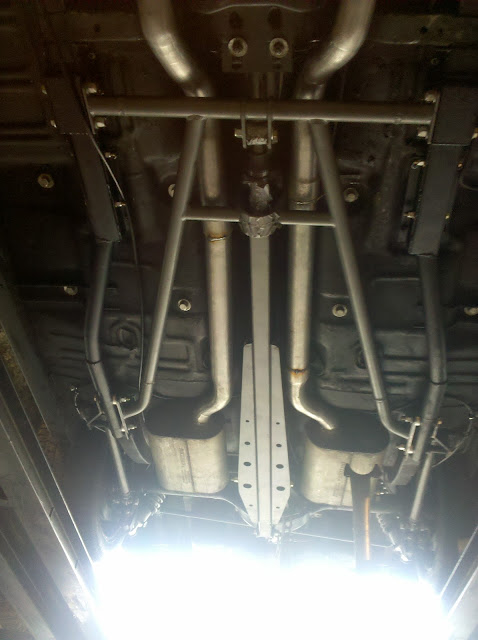

    The next problem was getting the exhaust done. Not too big of a deal but the exhaust shop spent a full 8hrs on a Saturday to only get dumps at the rear axle. I'll have to move my muffles behind the axle to get enough room to get the tubes over the rear end and have the exhaust exit out the back. These Flowmaster Super 44's are huge.
    After getting the exhaust in the car, it wasnt long before finding my next hurdle... or 2. First, while pulling the car out of the lift bay, I quickly realized that I had limited steering capabilities. It turns out that the header flange was in the way of the universal joint on my steering shaft. I was able to muscle it around and work through this though. A few days later it went back to them to be corrected.
