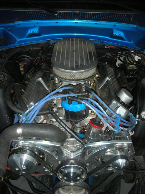

    I've got the new oil pan on now. Why is it so difficult to install the end pieces of the gasket? They never really seem like they fit properly into the channel provided and you're left wondering if its actually installed correctly. You'd think that someone would have come up with something better to improve installer confidence in the device.
    Power steering rack is installed and I now need to connect the low pressure hose.
    Im still having trouble getting my rear-end assembled. That driver side axle just doesnt want to go in. I'll try working on it some more this week but may end up taking the pumpkin down to have it reassembled with the splines aligned. I cant get them to budge at all.
