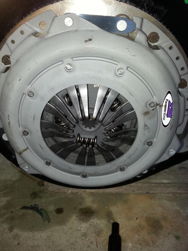

    Crossmember not ready yet but close, got the Zoom Clutch installed and the Lakewood Scattershield ready.............

    Got the new water pump on with help from my top mechanic (the wife lol) still got a water leak but I believe it is the lower hose this time, took the crappy hole manifesting Pure One oil filter off and replaced it with a decent one, bled the clutch and added oil, checked for leaks then I backed the Green Grabber Street Beast out of the shop today, just a little bit and took it right back in, it's raining and I have no hood on it yet, while bringing it back in I just gave it a little juice and popped the clutch, woah! speaking of the clutch, it is hydraulic and man was it smooth as silk and easy to push, pops right back up like it should too, LOVIN' IT!
