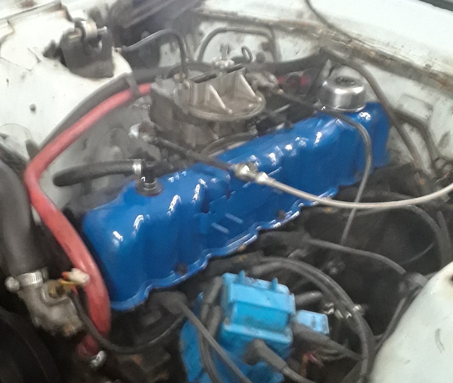

    I'm running the Pertronix Flame Thrower - programmable Rev Limiter HEI module with the DSII and Ford TFI coil. Centrifugal Advance is limited to @ 24 degrees and vacuum is eliminated with the boost . The '74 has a fairly stock bottom end 250 with a Vortech Supercharger blowing through a heavily modified 2300/350 7448 Holley, T5 OD tranny, Centerforce clutch and 3.80 posi rear. Cyl head is freshened, back-cut valves, 302 springs with no milling done to keep @ 8.7:1 SCR. With boost approaching one bar, it's adds confidence to have a rev limit when my right foot gets too ambitious ...
    [​IMG] . [​IMG]
