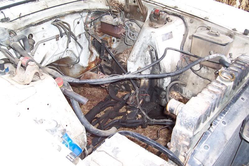

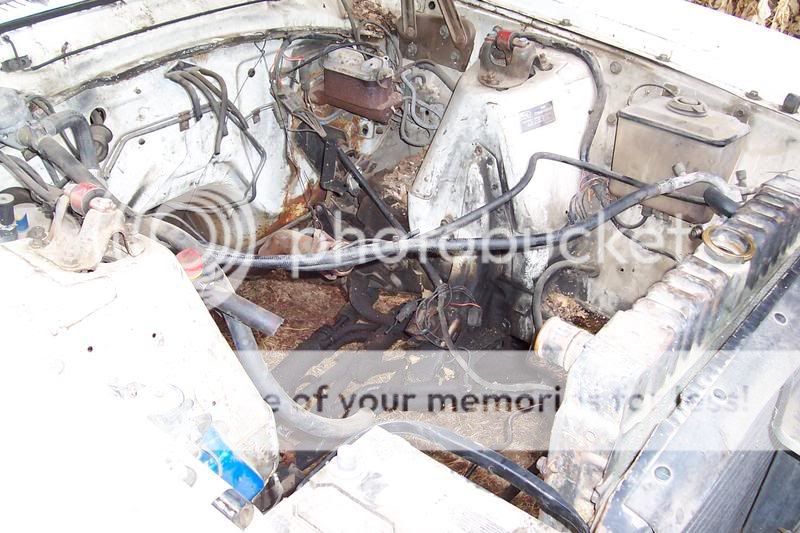

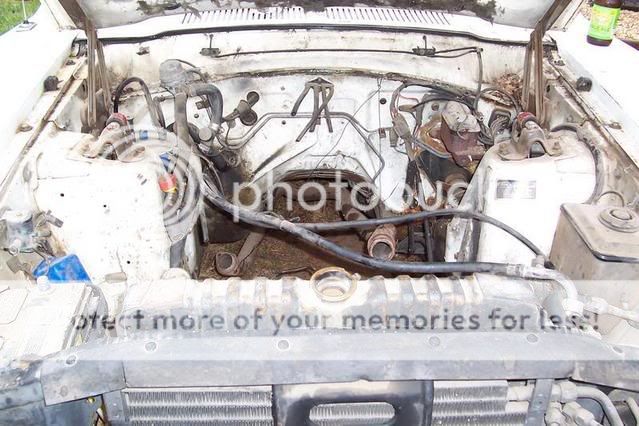

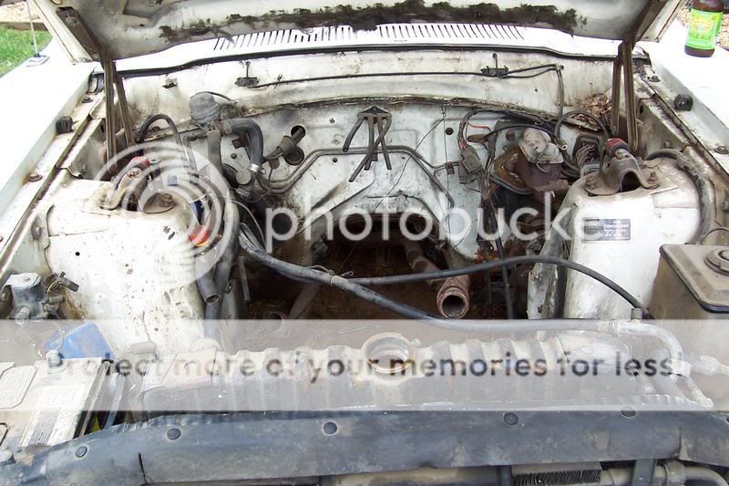

    Well round one of underhood cleaning, degreasing, etc... has begun
    here are a few new pictures after a couple hours of scrubbing. i used purple power full strength, and scotch brite no scratch pads.
    Couldn't get back here too good yet. I will do better when the master cylinder and steering come out.
    Here are a couple before shots for comparison purposes.
    I kinda thought i'd use black paint in the engine compartment, but now i think I'll have Carquest mix me up some matching paint and just touch up the surface rusted areas. I also used some rust-converting primer under where the battery box was. (this was the worst area)
    So far so fun. :thumbs2: Time for :beerchug:. I'm :badwords: tired.

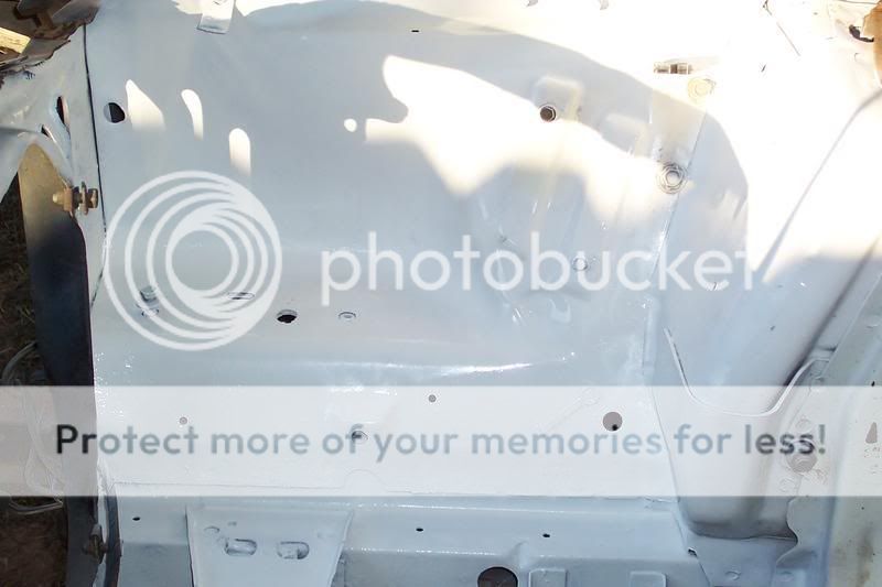

    Another day and a little more done.
    Here are a couple of almost finished shots of the battery box area.
    Still have to do some sanding, and beter color matching. But I don't think it's too bad for a rattle can job in the backyard, half full on IPA's :biglaugh:

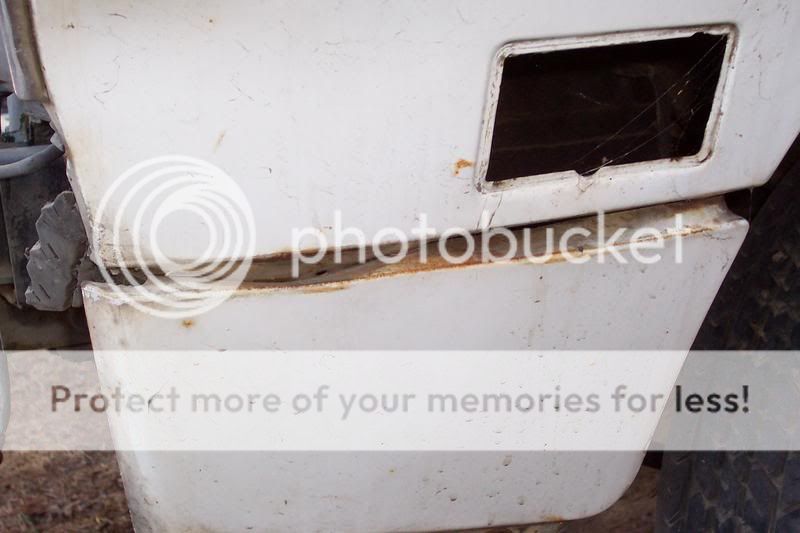

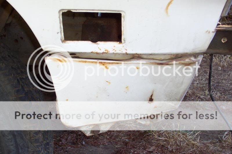

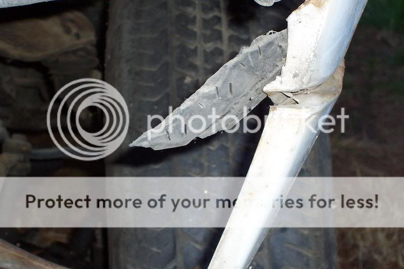

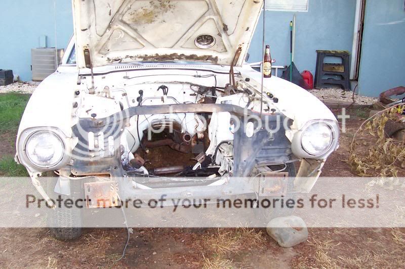

    Here are a couple shots of the banged up valances, I started work on theses already, and got them pretty straight.
    this side had a little help in getting damaged
    I found this wedged pretty deep between the valance and the lower portion of the headlight bucket.
    Closeup shot of the section of tire removed
    And last for tonight, I got it up on my "work pad" so that i can get under it to remove the seats, carpet, ect...
    Later:dance:

    if your going to small bumpers dont even worry about those valence pieces cause they have to come off anyway. its replaced with a one piece valence that wraps all the way under the front bumper. the swap was pretty easy and well worth it, just hard and expensive getting the bumpers, front and rear valances and rear 1/4 pieces. my car looked like yours except nasty yellow with a white top

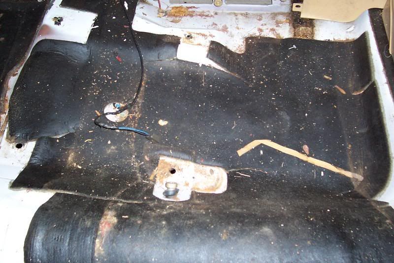

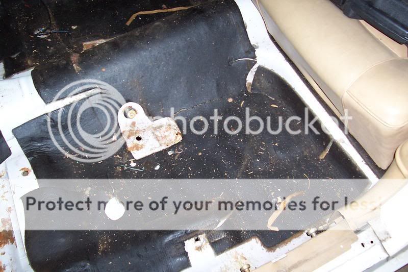

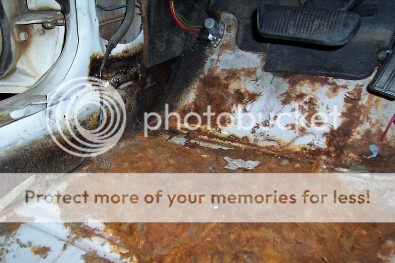

    Got kind of a late start this evening, but I did manage to get the front seats and carpet out. most all of it came out smooth and easy, then came the drivers side. Surface rust looks minimal, but it did take out the underliner and turn it a nice rust color. I peeled some of it back, and the floor looks good underneath still.(y)
    Nothing a putty knife, DA sander, primer, three beers, and top coat won't fix.
    Here is a look at everywhere else, lookin pretty good.
    Another day, a little more done. heck I'm not even as tired tonite. I must be getting used to this stuff.:)
