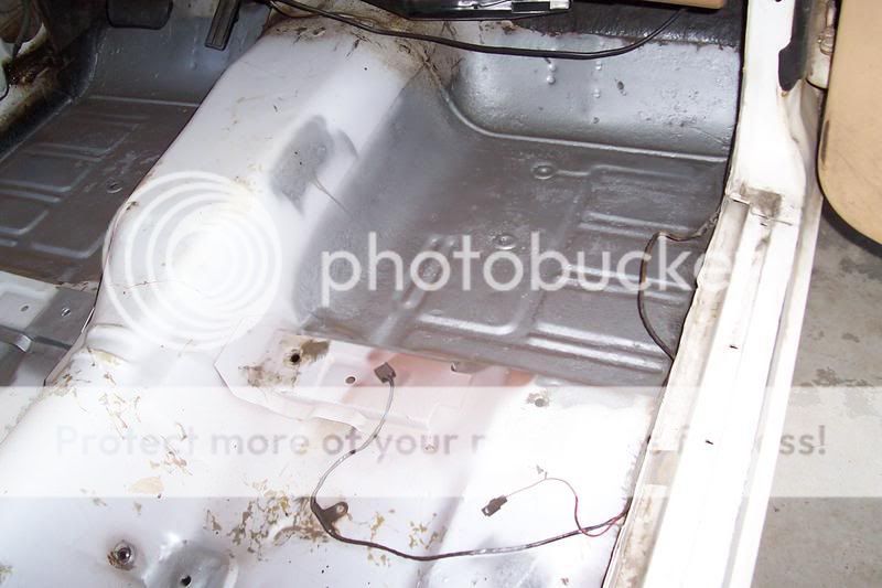

    A few more pics of the floor grief before fixing
    Thankfully nothing is rusted thru. I will do some rust conversion before priming and painting.
    Anyone have a reccommendation other than silicone for sealing the floor plugs so I can avoid this re-occuring?
    Is silicone not good for this?

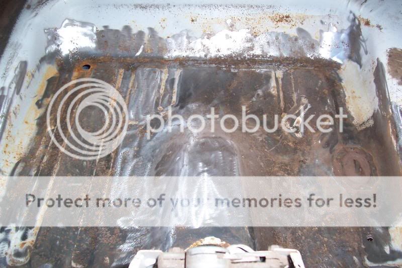

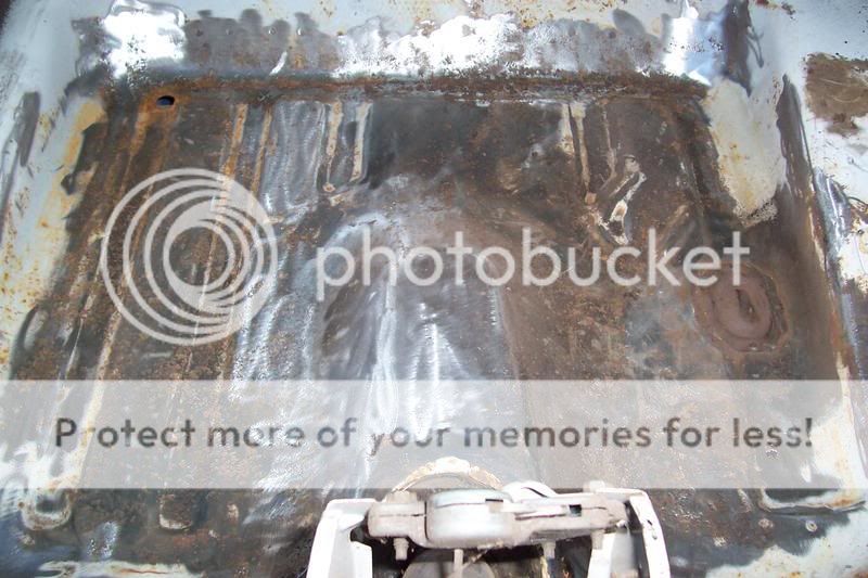

    Been a few days since I've updated but I'm still truckin along.(y)

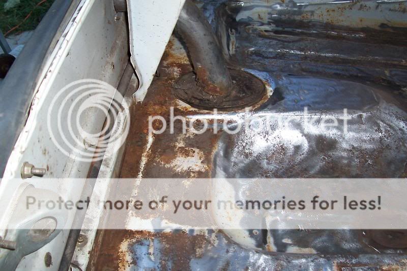

    Here are a couple pics of the trunk, a little more surface rust here, as well as some intense pitting, and a couple small holes.
    Didn't get any pics of the condition of the trunk floor before I started, but you get the idea.
    Im gonna try to get the tank dropped tonite or tomorrow, so that I can finish up the trunk. :dancing:

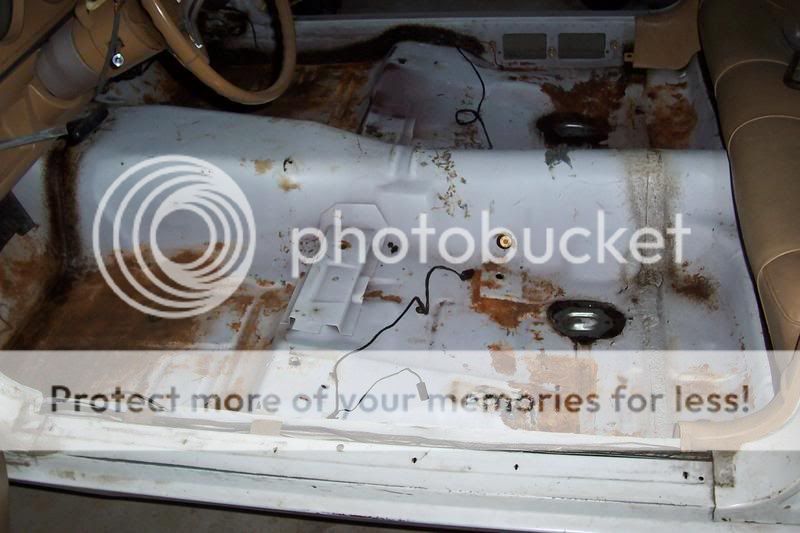

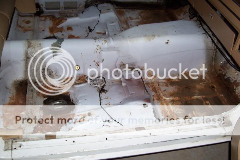

    And a couple pics of the almost finished floorboards
    This is definitely not the fun part to me.:biglaugh: I can't wait until phase 2 rolls around.

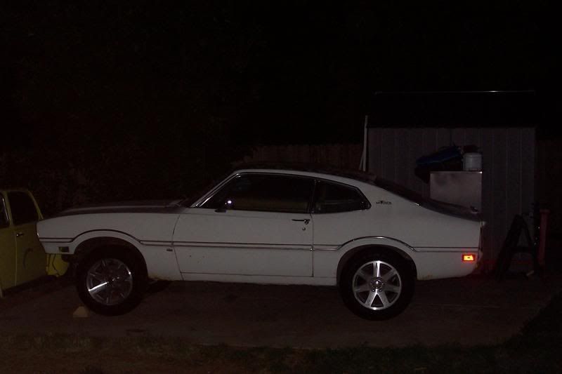

    I gotta couple pics of my temporary rolling stock. I had a set of 17x9's in the garage from my Chrysler 300 after a 22" wheel swap, though it might be cool to put them on the mav temporarily to roll it around. They sort of look okay on the car, but I have my mind set on bullits. Putting them on worked out for me in a couple different ways. One i cleared out much needed space in the garage, and two I kinda get an idea of what it's gonna take to fit 17's. the tires are a little too tall for me, but again this is only temporary.:)

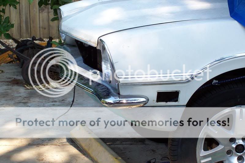

    Well I started the mockup of the front bumper switchover tday, and I must say, I think it's coming along nicely.
    I notched the stone guard instead on cutting the fenders, it was a trial and error process to say the least. Probably took 2 hours trimming 1/8" at a time. In the end I finished it off with some vac hose slit down the middle as a "rub guard". Im yet to bolt the bumpers up to the frame rails, but with the old bolts partially threaded in it acted as a nice support to line things up. Now I just need to re-align the hood to lose the gap from when the PO removed the engine.
