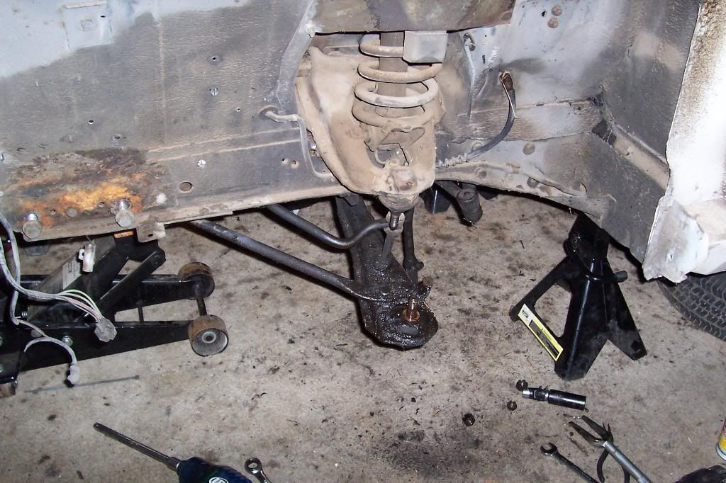

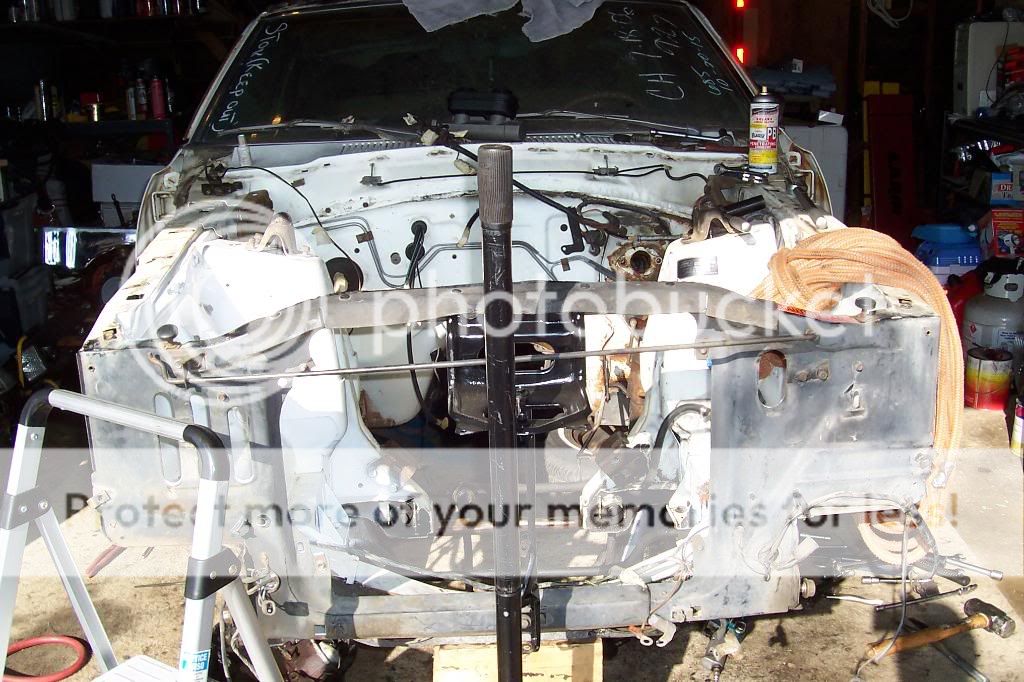

    It's coming off. The passenger side is almost done.

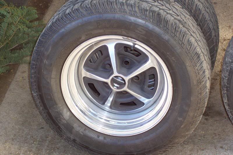

    Here are the pics of the Magnun 500's I went and picked up today. Two are in real good condition, as far as chrome, the other two are So So, but i think a set of beauty rings for them all will hide the pitting/peeling of the chrome on the bad two.
    A shot of the tires
    Tires are in o.k. sahpe, but one of the fronts has a plug, soi'm probably gonna buy two new ones for the fronts at least, if not spring for a whole set.
    I'll have to get some pics with them on the car too.

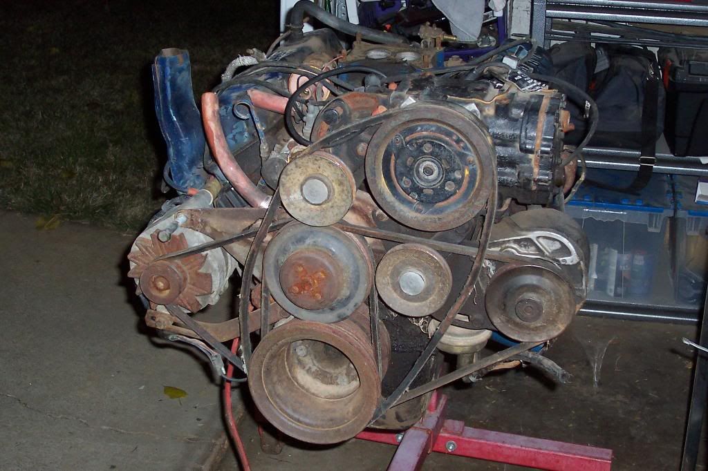

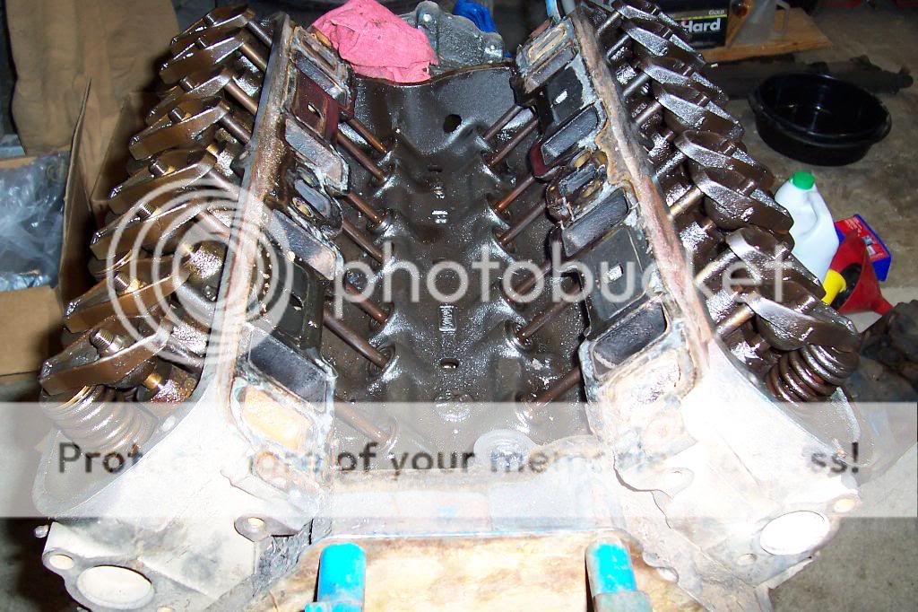

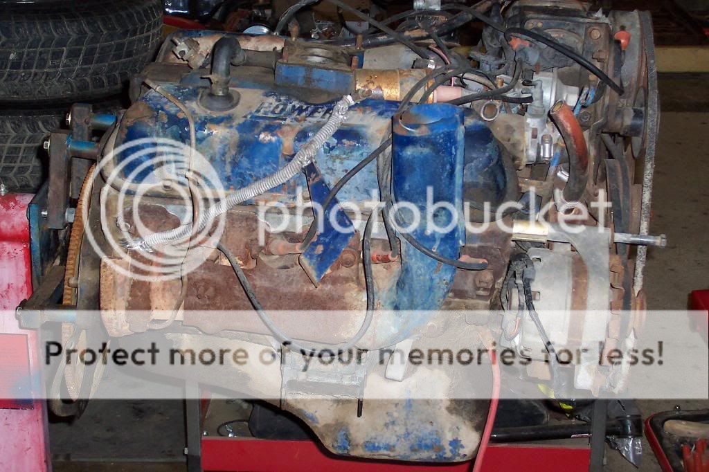

    I picked up a 302 a few months back from a guy that took it out of a 68 Cougar.

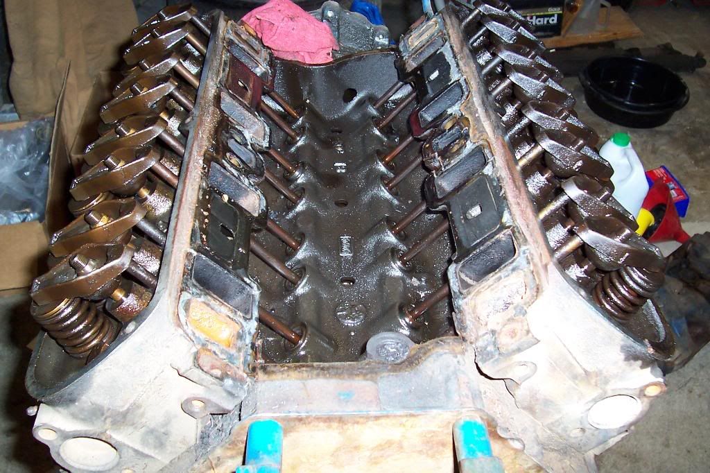

    This is what it looked like when I got it

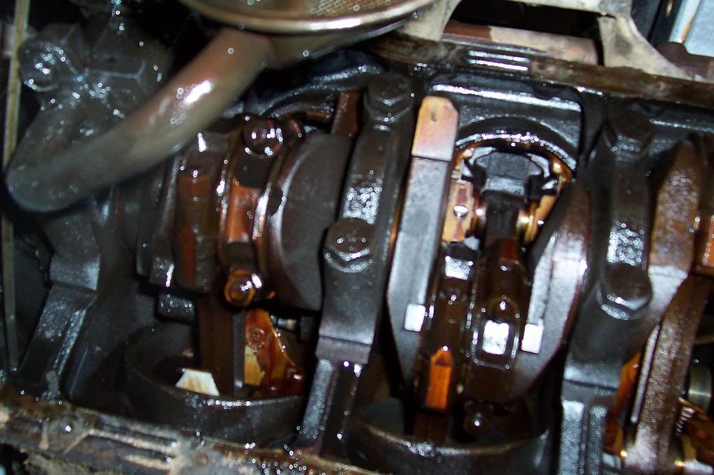

    After tearing into it some

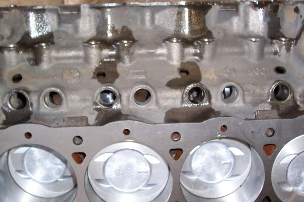

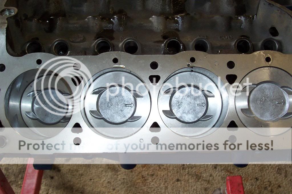

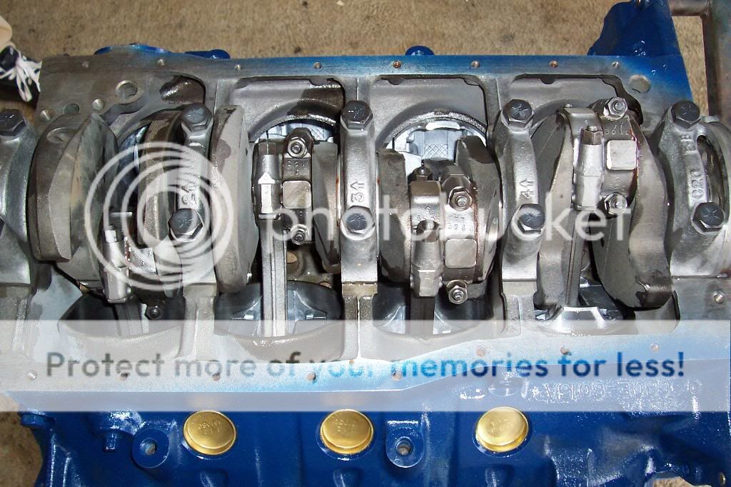

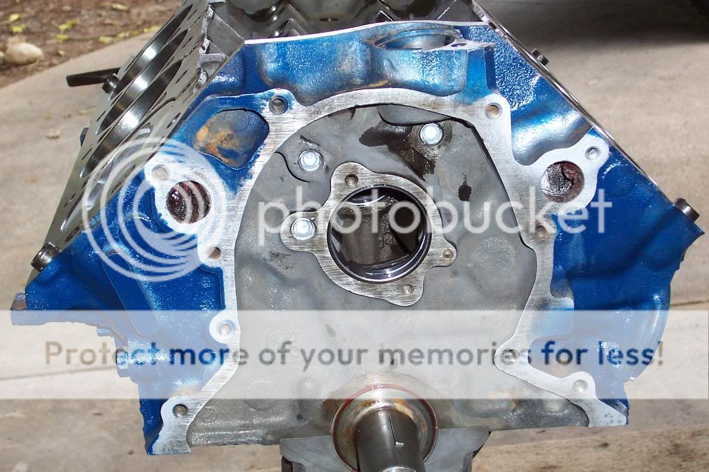

    Well needless to say, there was NO way i was gonna run that as is. So after a couple months of putting some money aside I had the engine rebuilt to a 306 using the stock crank as it was good, forged rods and hyper pistons, new rings, bearings all the way thru etc...
    Now this is what I got back
    Now it's time for the fun to begin. I'm not going with a radical cam or head so I got it all matched up to a set of 20K mi E7's I had in the garage. I had them deck the block to leave me with a CR of about 9-9.5:1. So I can run 87 and make interstate trips. I think I'll be real pleased with the outcome. I have been dealing with this shop for a long time and I like the way they involve themselves in the builds.
    I'll get more pics up as I get the HCI installed. Pretty much all down hill from here. I got a built C4 And a TCI street figher going behind it. So I can have some fun.:character0182: I will probably go T-5 later down the line, but for now the Auto will do me good.

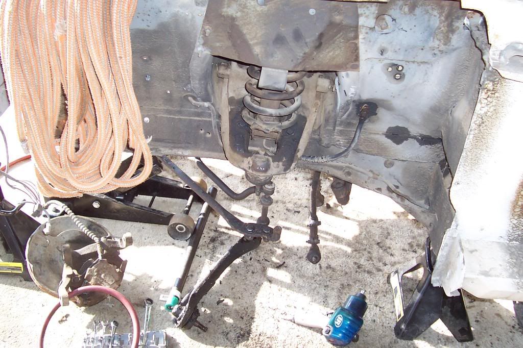

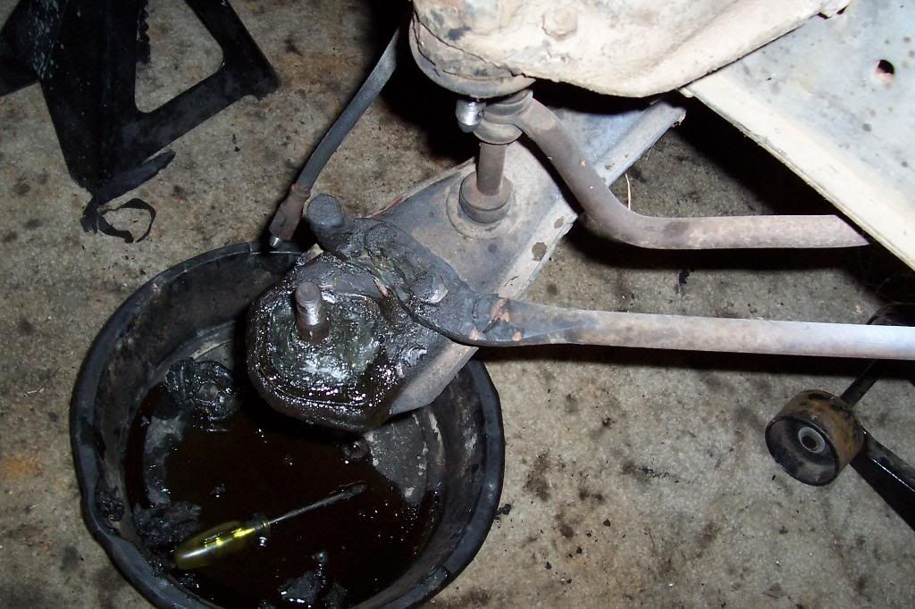

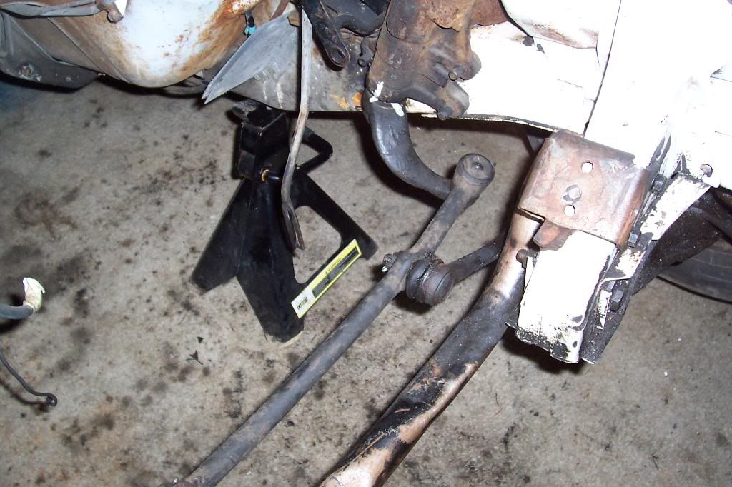

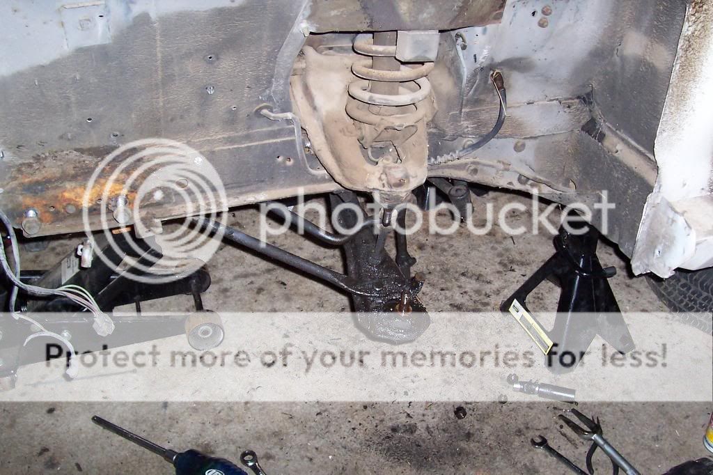

    Well I made a little progress last night before going to bed around 1am. I got the old drum stuff out and decided to replace the upper and lower ball joints since I was that deep anyway.
    I also got the manual steering conversion done and ditched the power stuff. I'll post it in the sale section for anyone that wants to take that off my hands. I think I'll be more than fine with manual steering.
    I got a chance to take a ride in my buddies mav with power steering and didn't really think too highly of the way it felt + Im running long tube headers and want all the clearance I can get.
    I'll pick up the ball joints today after work and try to get everything buttoned up tonite. I'm also gonna cut a coil off my front springs, so I have to get those out tonite too.
    Here are a couple of pics I snapped off last night, and today at lunch.

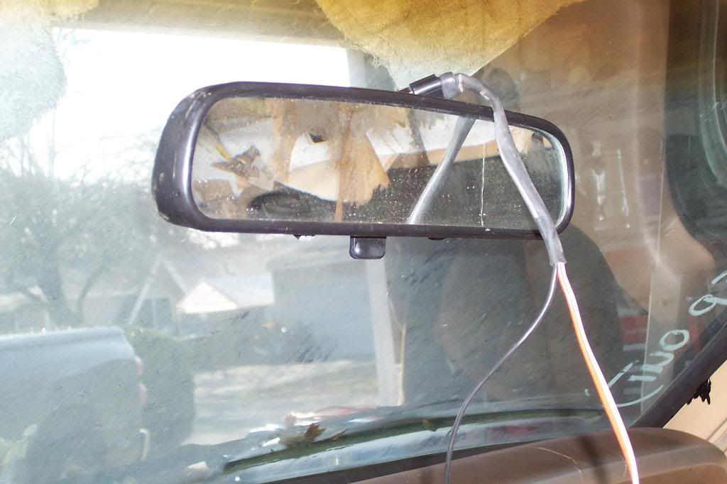

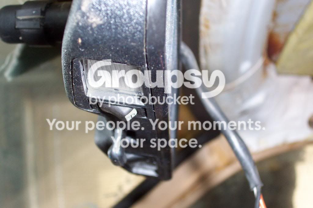

    Also threw in my new lighted rear view mirror, still have to run the power wires, but it's in.

    Manual steering parts installed
    Bad ball joint boot, good ball joint.:mad:
    I'll have the fronts done tonite. I'll probably do the rears next weekend.:huh:
    All depends on what happens tonite. I was pretty whooped last night, so after work I'm gonna take a nice nap for an hour or so before I get started.
    But I should be able to have the fron buttoned up, and maybe get the car turned around to start on the rears. We'll see. I'll keep the pics comin.:thumbs2:
